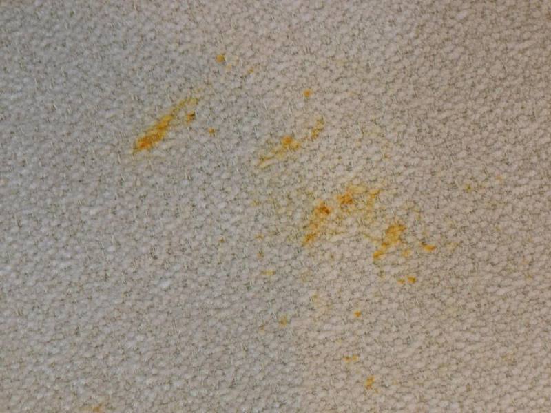

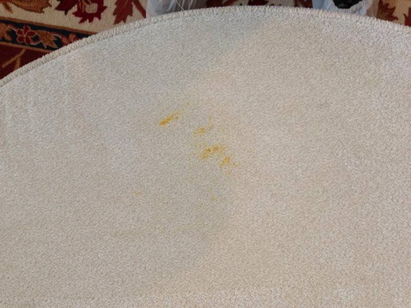

Customer dropped Tiger Lily blossom on her white ottoman. The stamen left this stain. Any suggestions for removal?IMG_0124_zpsec5a4360.jpgIMG_0123_zps5233b6e6.jpg

I think you'll ulimately need peroxide to remove that. Sometimes you get you can get lucky and it will come out with a general purpose spotter and extraction...but I doubt it will work if that's a cellulose fiber.
A few warnings:
1. You could end up overwhitening the area that you treat with the peroxide. Make sure you have in writing that you can't be responsible for any color difference. I know that "a little whiter and brighter" will be a 100% improvement over the existing stain, but I just helped a cleaner avoid paying a 16,000.00 claim after removing a urine stain from a similar fabric.
2. If you go with anything stronger than 3% peroxide, and the fabric is has cellulose fibers in it (probably does), it may weaken them. It might not show up for a while, but if they sit on it and it splits in the same place the stain came out, they'll remember you treated it.

Looks like a Chenille fabric , I have on 2 chairs at my house. That looks like a toughy, Shane.
