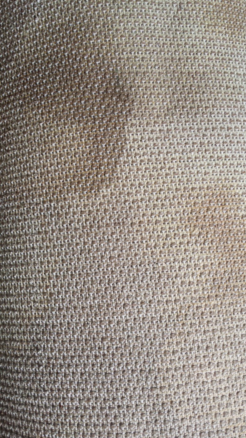

This is what I refer to as "waffle" type backing.

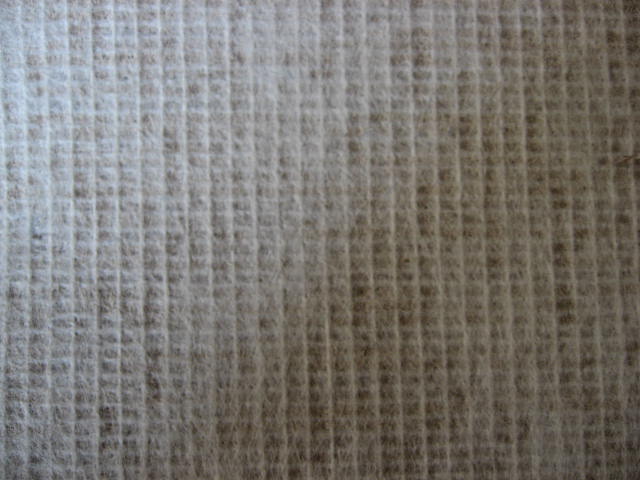

This a different backing from a pissy synthetic shag that I have cleaned 3 times already.
Can only accomplish barely lightening the stains....

Latex cement. Made of limestone dust. CALCIUM CARBONATE. I use something like osr on it. The second picture is a flatweave woven may be wool can't tell. May have jute as well. I would mother use . Enzymes work well on those flatweave as well then extract out.
