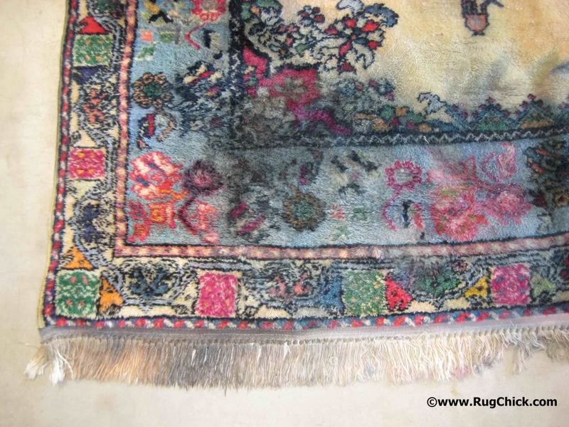

Here's a rug that's got some serious problems... well, it's a rug that lives with a pet with serious problems.
Look at the corner. Not just dye migration, but complete dye loss in some areas (probably from attempts at cleaning), and it does have signs of mildew and dry rot on the back side.
She wanted the rug saved though.... washed and the odor removed.
You guys got any photos of damage like this? We don't get it this severe that often, our clients are quick to wash when an accident happens.

Doesn't it make you sick when people allow their pets to ruin pieces of art like that?
My brother Dan use to be our rug guy and I was the upholstery cleaner, we spent a few years working several feet from one another and I was always amazed at how some rugs were just being ruined by pets.
He was always so proud of his work, just to razz him I'd tell him I don't know why you're working so hard on them. People are just going to walk on them and allow their pets to piss and sh*t on them. :mrgreen:
Man that would get him going, but it was true. If their child did it, they would be very angry. Their dog? Well he had "an accident."
It didn't look like an accident, seems like they were hitting that rug with regularity! :shock:
