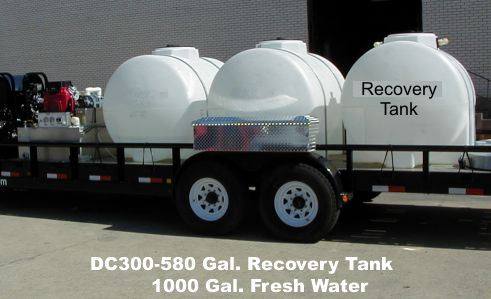

Another advantage is they can carry more water as on this airline TM trailer:

I like the pic of the trailer above. Problem is the weight. must have a good diesel and electric brakes.
