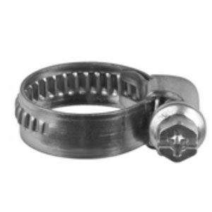

leaking at the clamp, Glen?
cut it an re-clamp

Glen;
My suggestion as a possible solution is to replace the normally cheap hose with pressure hose and re-clamp with the screw clamp (or jubilee clamp) shown by Mikey above.
Easy to do and you'll be a lot happier!:clap:
