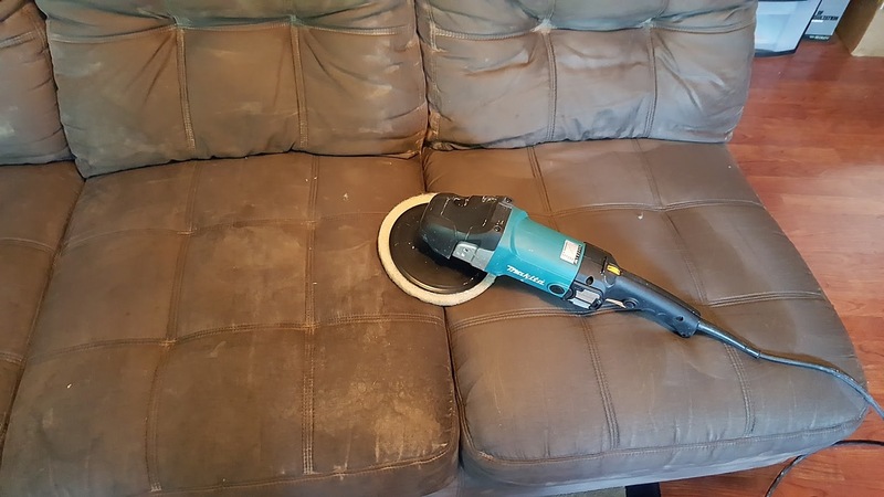

But on Micro Fiber this soiled it's time to bring out the heavy machinery.
al7_nFwLXxwlyCHLY_r3PcQkO9heBPezxCS3WXDcr32ujSicXtyagqaKES4xPdzJTu5LELeiv38EAsj3iA=w1699-h955-no.jpg

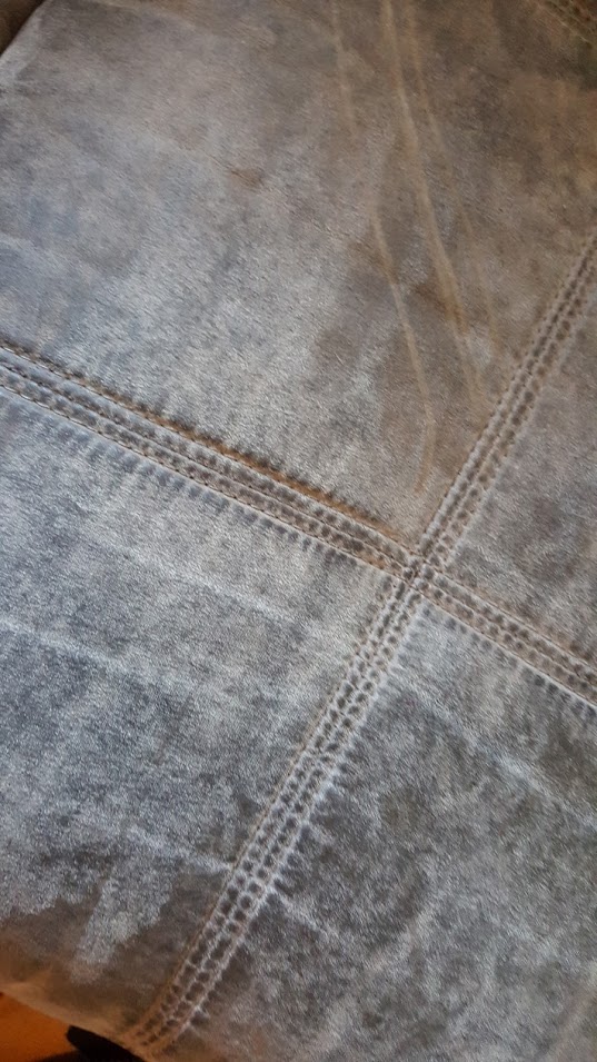

I only had the Champagne pad on board and could have used a light brown..As it was, I had to scrub and rinse twice on some seat areas to get it all out..
Before..

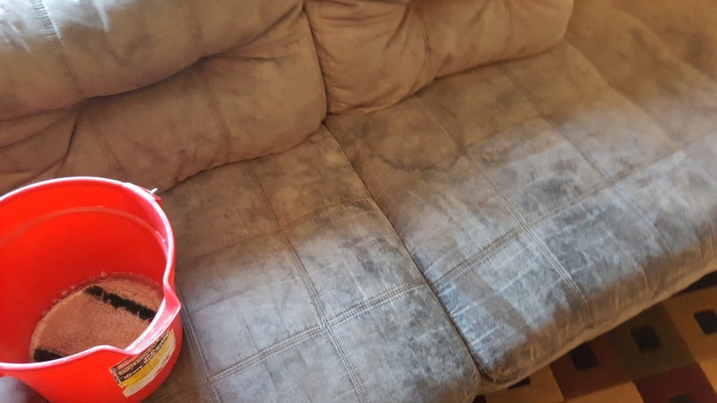

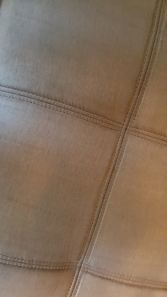

After (but still wet)
loDr1GUFYtNRqHs9NMV58BQw9dGSuNOK3Bzr45q30NYvFf8AMO8r39FyrhxF_tlkjLnoSBBdBBvJWFveWnA=w538-h955-no.jpg
Be prepared to tarp or take outside as goo will be flying..

We use the Makita 9227c as it is our favorite hand buffer.
I used Mr. Makita and a home made white scrub pad on a leather sofa the other day. A gentle but insistant scrub at low speed, frequent wipes and ta-da!
