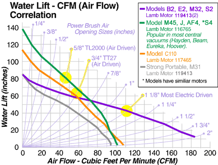

Here is a simplified chart which shows a single hi-perf 3-stage vac, along with one & two 2-stage vacs (two in parallel). A CMP 14" wand has an effective orifice of ~3/4".
About 60 CFM for one 3 stage hi-perf vac.
Lamb has printed all the graphs.
Those charts are what we use to figure series & parallel combinations.
Larry

I read a 14" wand as having a much LARGER slot area, so Larry must be taking into consideration an educated guess with restriction in place of the wand lips against the carpet.
Other than that, I pretty much agree with him in reference to that chart, except I steer clear of Series configurations if at all possible, putting one motor BEHIND the first just adds 50% to the first motor's Waterlift, nothing to it's CFM, dollar for dollar I'd rather put that money into the CFM and hold steady on the waterlift I already had, I want over 120 REAL CFM at my wand, 60 REAL cfm centrifugal vacs don't cut it for carpet cleaning, flood work is a diferent story.

If you look at the graph above you will notice:
1.The green graph - 137" Hi-Perf 3-stage
2.The purple graph - Two Std. 85" 2-stage vac in Parallel
At the typical operating point - 3/4", the green graph provides more recovery CFM & Lift.
Larry

Yes Larry, they are very close at a 3/4" opening.
But a curious thing occurs at a 1" opening, the CFM is better by 50%, and only drops the water lift by 12%.
So I wonder....which is a more real life example of a glided 12" or 14" wand?
