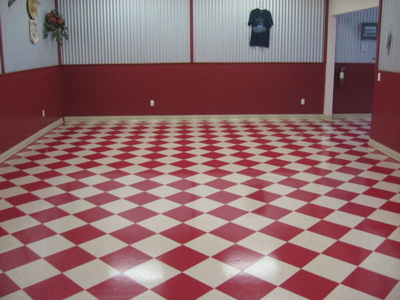

VCT Floors I did since I had requests for pictures
TimP
May 19, 2007
4,055

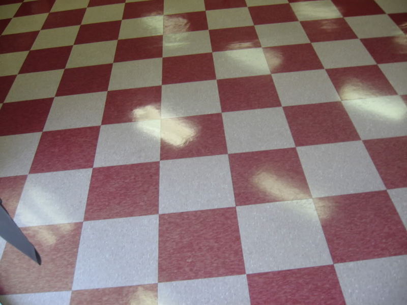

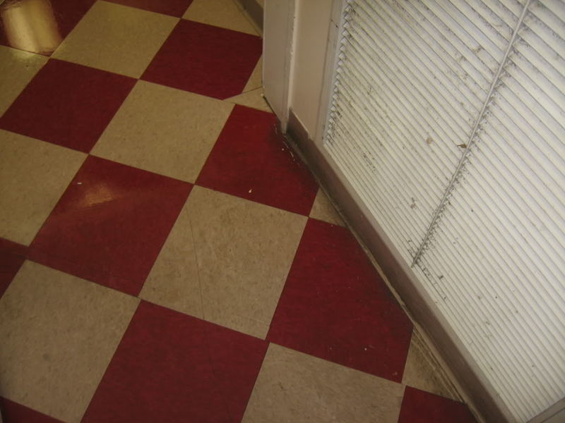

This was an area we didn't do ( the main area was worse than this room since it wasn't being used for customers)

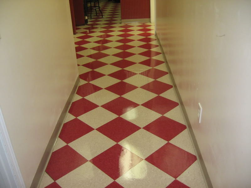

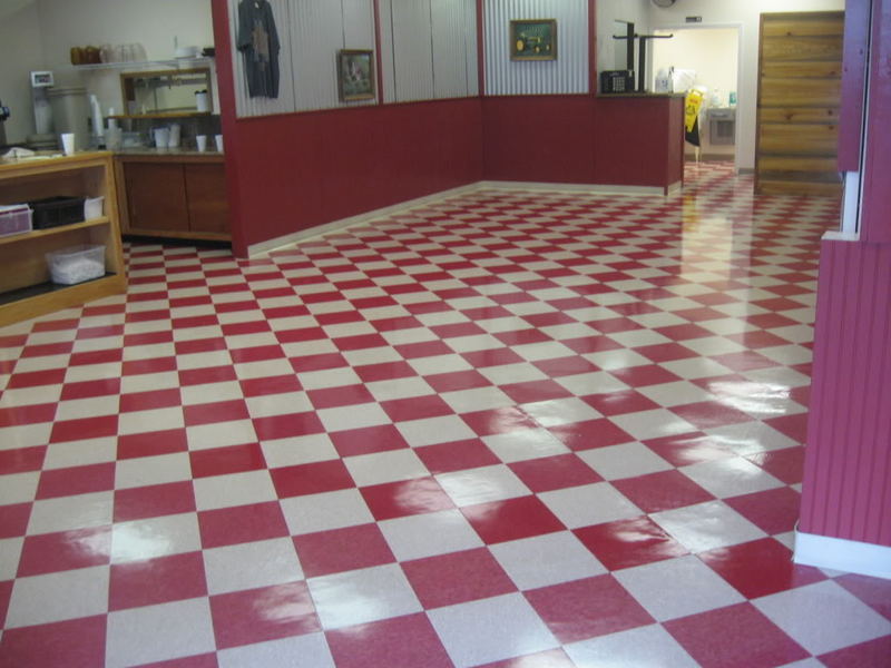

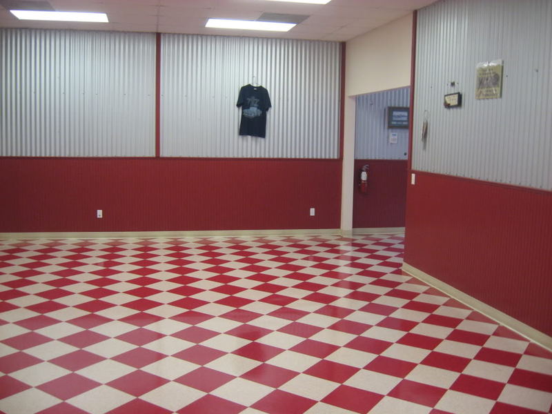

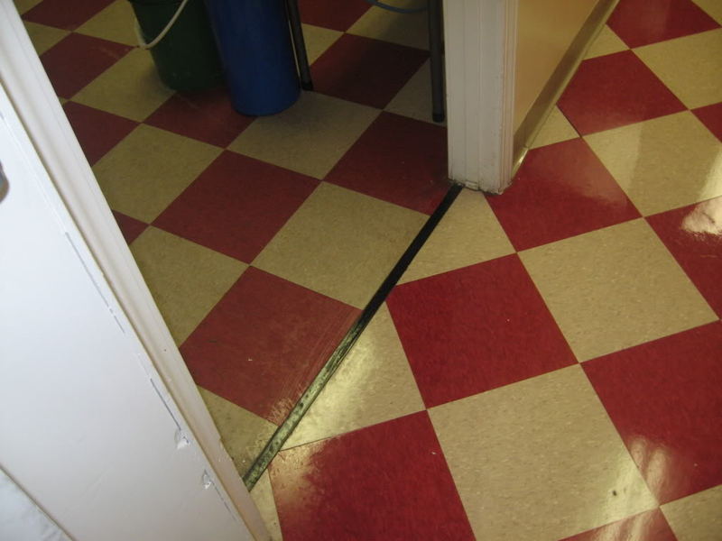

These are areas are we did next to an area we didn't for a contrast I know it might be a bit sloppy but no customers saw this area

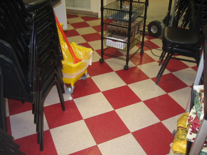

you didn't put that plastic sheet cover over the wax in that mop bucket did you, or was it a bucket liner
any more I just get the wax in gallon jugs and use a micro fiber wax mop
I put some trash bags in there as a liner but so far they never hold all the wax in the bag.

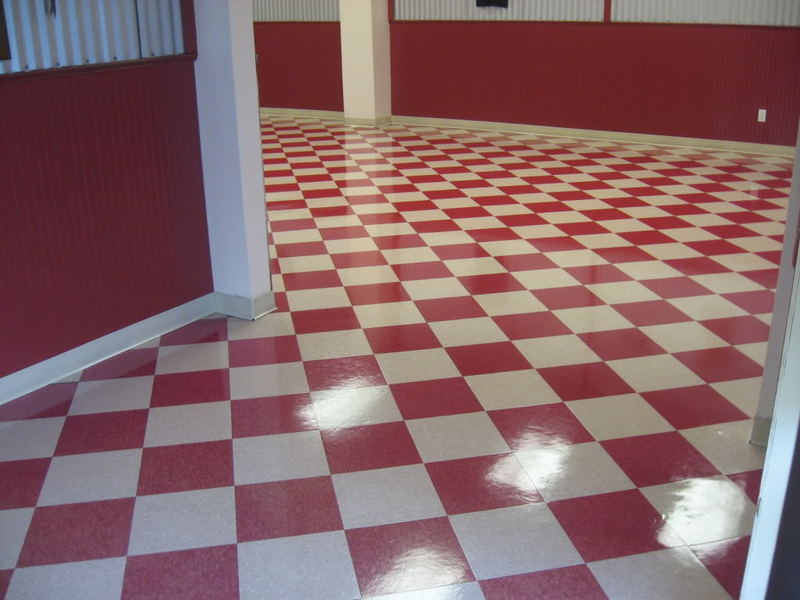

These people had someone supposedly strip and wax the place before and they said there was no comparison to the job I did compared to the last one. The corners and edges were noticed right away. The shine is something they hadn't seen on the floor ever. I think most people who do vct around here put 2 maybe 3 coats on in the beginning and most if not all never do a complete strip, just scrub recoat and call it a strip job. And I seriously doubt any buffers are used in a scrub job. One guy around here that I know of that does this work, I've never seen have a buffer.
