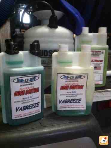

stuff smells great and price is lovely
GCCLee
Jan 29, 2012
5,113
East TN
C. Lee
DD-12
Flavors !
