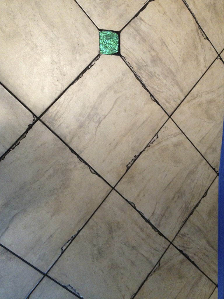

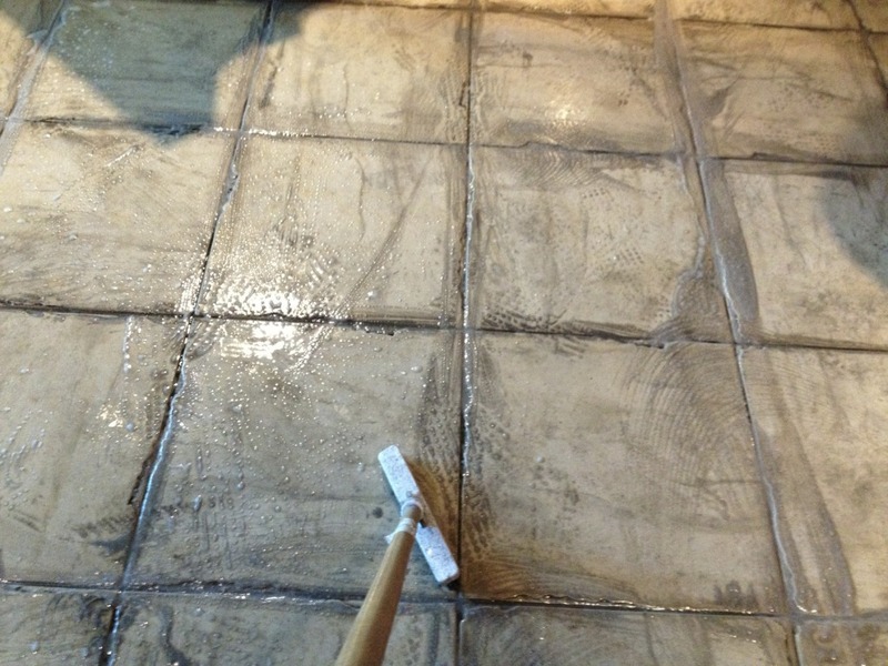

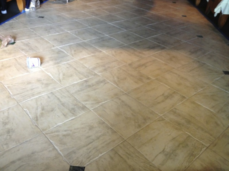

Do you have any pictures
yes
Before
During
After

Did you do all that with a grout brush or did you use a machine and just used the grout brush here and there?
Looks damn good regardless!

Looks great! How many square feet?

I used a grout brush to agitate every single inch of grout and a SX -15 at 1200 psi
How many square feet and how long did it take you? Did you have to really bare down or did the product cut through the grime build-up fairly easily?
