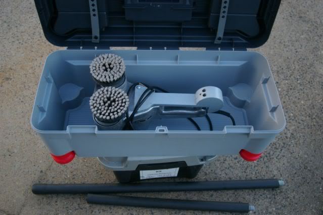

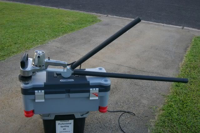

Mike, I like to use the Cyclo / Mini HOS with small extension pole.
It saves my back, I clean the risers, bottom to top, then come back down cleaning the treds.
The short pole also fits inside the Stanley tool box along with spare brushes of different grades.
I prefer the Cyclo / Mini HOS over the Makita with pads to get the crap out.

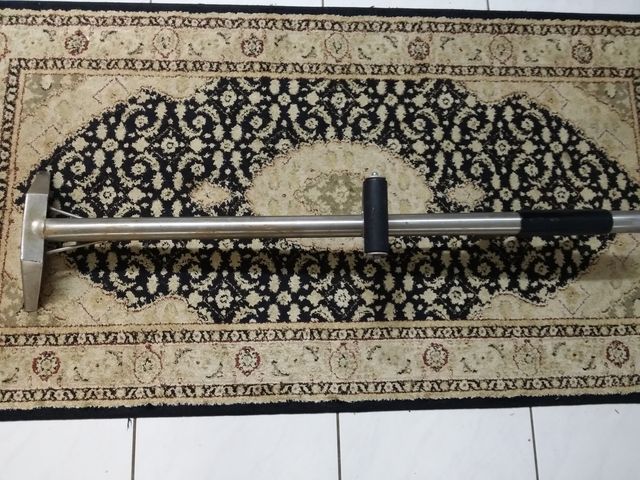

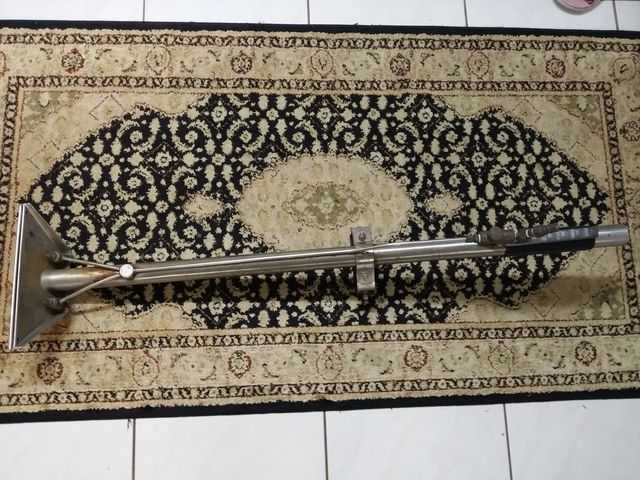

When I feel that the stairs also need to be extracted, I use a 40" straight stair wand after agitating with the Cyclo.
I WILL NOT use an upholstery tool on stairs due to the tacks from smoothedge etc;
