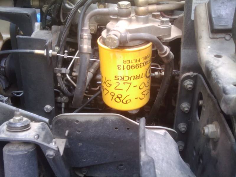

Thanks for the help everyone! Yesterday I spent all morning scrubbing rugs and all afternoon servicing the UD. Then last night went out and scrubbed rugs again. This is the first chance I've had to log-in and I'm overhelmed with the level of support. Thank you very much!
Decided to start with the easy stuff first.
I replaced the fuel filter. After spinning it loose I noticed a date of August 2005

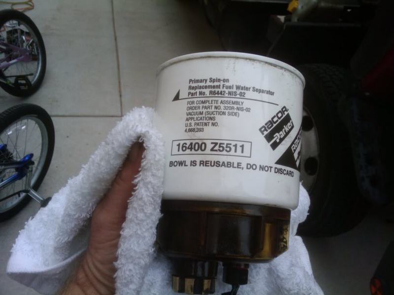

Then, removed and cleaned the sedimenter

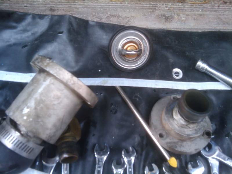

Also, replaced the thermostat

Question on the sedimentor,did you replace or clean? If cleaned how?

Brad, I cleaned the sedimentor in a coffee can half full of deisel, put the lid on, and slosh around. Rinse and repeat.
When replacing the fuel filter its a great idea to fill it with diesel fuel first. Then, loosen the bleeder screw, pump the primer knob until air stops coming out, tighten the bleeder screw and your done.
