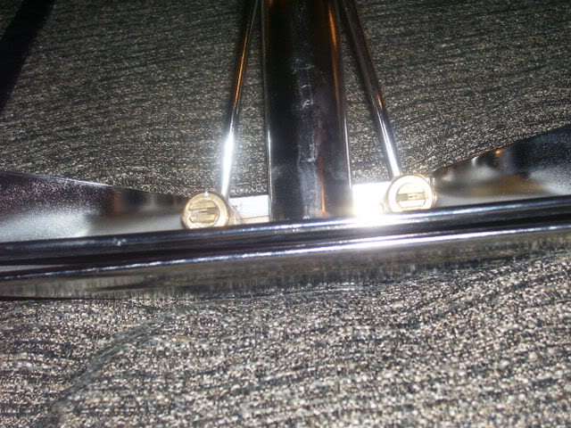

Today when I got to the job and fired everything up all was well..
But once I started using the wand I realized the jet on the left was clogged and shooting the water in stutters...
What is it that can be done.. I still have the same ol' AW29 with 2 jets...

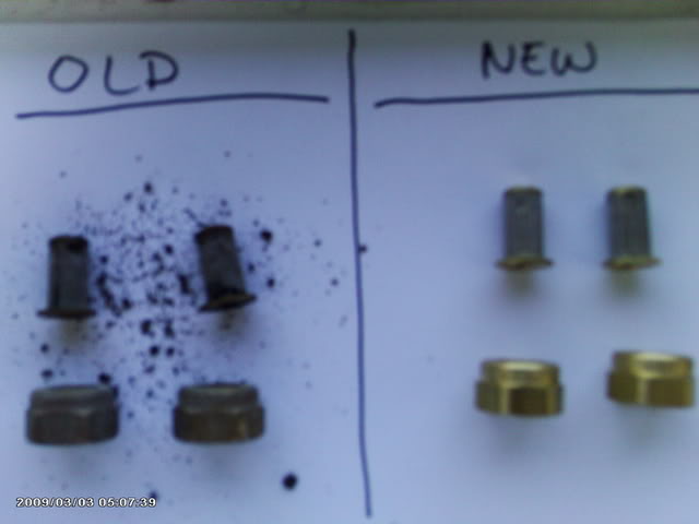

Clean the ones you have. If its a 2 jet wand they might be in under the jet. If they are scaled then soak in some descaler the blow off with air. Also should be a screen in the fresh water tank on the bottom .

unscrew the brass nut, then take the tee-jet off, (it will probably come off in the nut anyway) now you're looking at the end of the strainer on the wand
you may need to "gentlely" pry it out.
cause It's likely packed with crud/scale
spray it off and inspect it.
If the screen is blown thru the body the tiniest bit, it's junk.
if all is in good order, you can reuse it
oh...DON'T use a needle to poke the brass tee jets.
You'll ruin them

You should install a filter on your wand just before the quick connect. That you can take out and clean easily- instead of messing with the jets all the time.
Descaling the whole system could help too...

mine used to clog all the time, though it took a month at a time. Start noticing because the spray pattern and flow just wasn't the same.
Always keep your fresh water tank as clean as possible,
a filter before the wand and before the cleaning unit will help to
pop out the screens, clean them, reinstall and go for it.

i bought new caps because one of them was cracked and the other was showing it wanted to crack... the salesman suggested as long as i could see through the jets they are fine... so i took his word...
