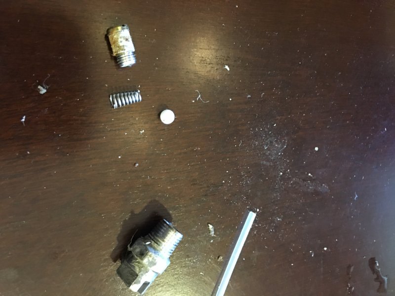

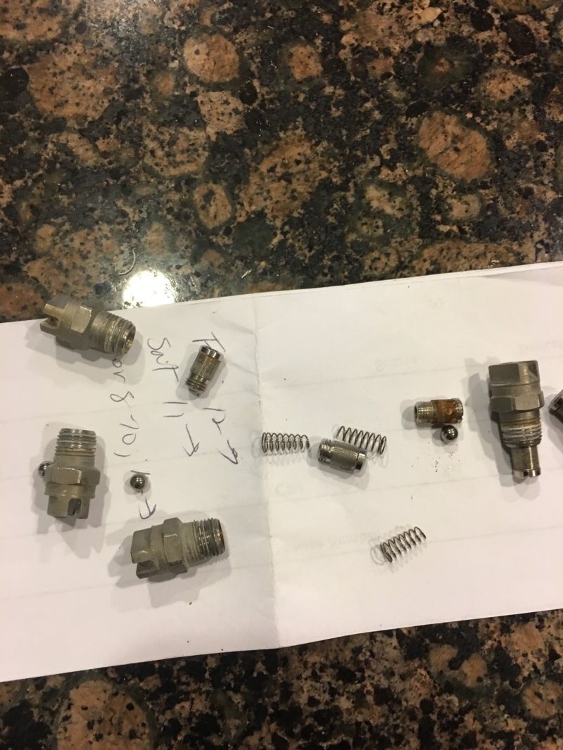

Some places have stubbies with a screen and filter to help reduce drips and blockage.
Joe B new springs and stubbies are much improved.

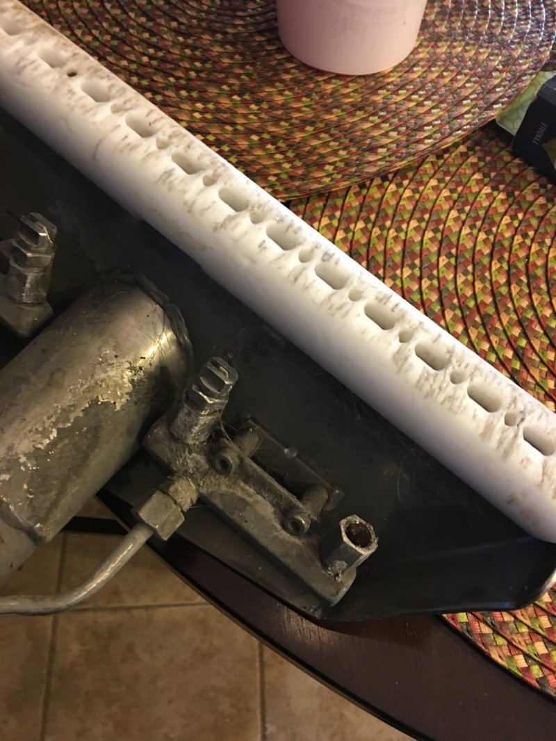

Do you have a glide on your wand? If you do, go with a 6 flow
If you're not using a glide, bump it up to 8flow
