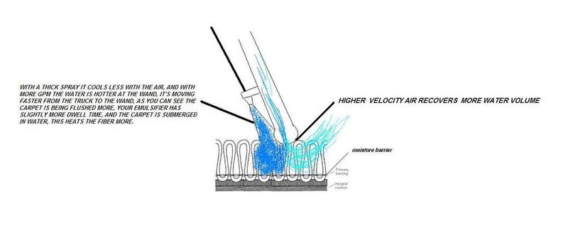

Greenie, I was thinking that if the jets are directed too much at the glide, you would be flowing mostly over the surface of the fibers and straight into the glide.
I actually had adjusted my Ti wand just for CGD to just skim the glide, exactly like Lisa described. So if someone adjusts there spray angle exactly like that but on cut pile, wouldn't the flow be directed up too high at the fibers?

Yes, if they adjusted it on cut pile instead of CGD it would be too high. that is why we recommend adjusting on CGD.

The water only touches the glide/lips on CGD, on cut pile it strikes behind the glide/lips. Any water hitting the glide/lips is still flowing through the carpet before sucking into the slot/glide because the wand is in full contact with the carpet. It cannot flow around the glide and into the slot without going through the carpet first.
Some wands cannot be adjusted, so on these wands, we must do the best we can to come as close to that as possible.
By moving the angle of the jets, you can now safely flow more water and higher pressures without fear of under-drying the carpets, leaving pressure distortion marks, or wetting the backing, getting a better one pass clean.

Angles do influence the "Impact" of the jets.
Assuming = GPM, pointing the jets straight down will have more impact and clean the carpet better. More chance of streaking at this angle.
The real question is how much more GPM does it take at an angle, to equal the original GPM pointed straight down ??
Once you achieve equal cleaning with more GPM, does it dry faster?
That is the REAL test.

Yes, because the water is being directed where it needs to go (the wand lips) not deeper into the carpet and possibly the backing where removal is more difficult and less efficient.
I would also argue your assumption that direct impact from above, at the same flow and pressure is cleaning better than at an angle to the fiber. Direct impact from above is simply pushing the water and soil deeper (where you might not see them as well), not removing them better. ALSO impact directly on the tip of the fiber makes the fiber much more susceptible to damage from pressure marking/tip blooming, and also greatly increases your chances of wetting the backing.

Eddie, Larry means well he really does. He just misunderstands the results of many of the test he runs.
Jets at a 90 degree angle will penetrate the backing at a ridiculously low psi. Not only that, as Lisa said more of the soil load is available to be forced into the backing with jets at 90 deg.
I can't believe this is even being debated. This has all been tested in the field. It is absurd to argue 90 deg over 45 degree jetting.

Get a piece of cut pile nylon, the thicker the better, put some padding under it to simulate, put a wand on the edge of it and make a wet pass backwards and observe the solution from the side as it penetrates the fiber and passes over and through them and up into the vacuum slot.

Ok, let me say it this way. I do NOT want the water from my jets hitting my glide.
Period.
I want EVERY water molecule to hit the carpet.
There is no doubt that when the water hits the glide and creates a "sheeting" action probably 25 to 30% of that water does NOT get to the carpet properly.
I do not want that.
Now if the rest of you want that...we have no argument. I don't.
Maybe I'll have to buy the Greenhorn wand or whatever it is called and I will be proven wrong.
I just don't see how limiting flow to what I am attempting to clean is a good idea.
Now, if the jets are angled to impact the carpet right behind the glide without hitting it....fine. No problem there.
I just want every bit of water I am using to hit the CARPET.

I have the 2 Greenhorns. I don't like the solution to strike the glide either. I made a simple tweak to remedy that. The jets are angled to a point that it doesn't matter anyway. I generally don't clean over 500 psi. But I have gone as high as 600 with out violating the backing even with the spray pattern hitting the carpet fibers directly.

I strongly suggest that everybody will get better cleaning with ALL of the water hitting the carpet (I agree with Rex ??).
We distribute both angled-jet and conventional jet wands.
We do use fewer jets than some of the other wands (2 jets on 12" and 4 jets on 14").
We clean many carpets @ 550 PSI and I don't see the back wet with either jet angle.
