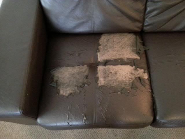

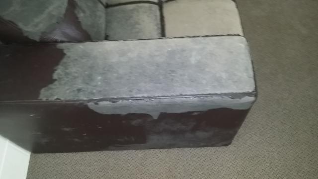

This is a Bycast sofa that I inspected in April 2013.
It was in a rental property & six months old.
I advised the RE agent to contact the store & have it replaced with a fabric sofa.
The owner did not want to as they had bought it for the unit.

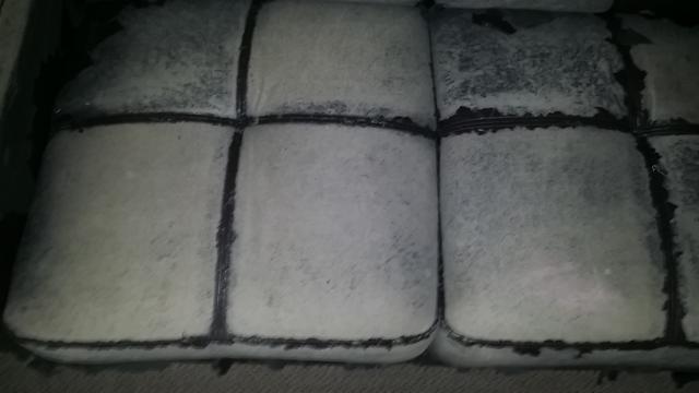

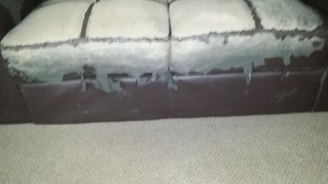

Same sofa inspected just this week, 14 months later.
The owner is screaming and now wants the tenant or the real estate agent to pay for a new one.
What would happen in California in this instance ??
