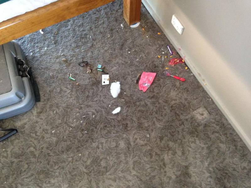

After I made the walk through video I tackled the master bedroom. There were surprises if all kinds everywhere

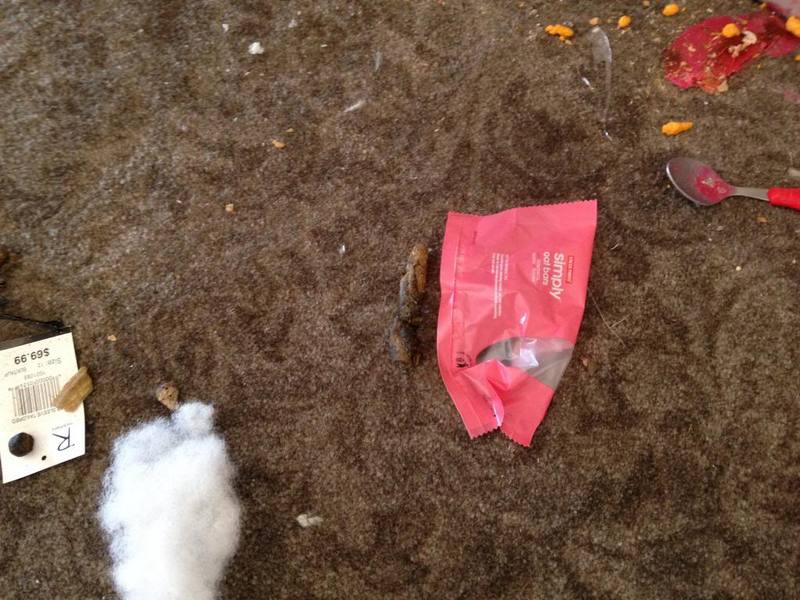

Including petrified cat shits. These are right next to a kids sugar candy sweet and toys. Yay,

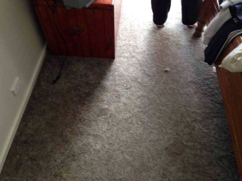

But the - real fun was the discovery that there was a HUGE deposit if urine just inside the doorway. You can see it in this photo, the urine soaked area is a similar shape to a fish or keyhole. The carpet is yellow there and greasy with lipids.
It Stucking Fank....and Knuck Fows how ANYBODY could stand to sleep in there. The whole house just reeked.
How can it be dealt with under such constraints?
Like this.....
Chemical is Masterblend Skunk Odor Control.
http://youtu.be/T0t6u1UhpUM
When I say in the video "it smells interesting" I should have said "my eyes are burning".
Pulled 22 of those. That room took a while but we hit the pee out.
