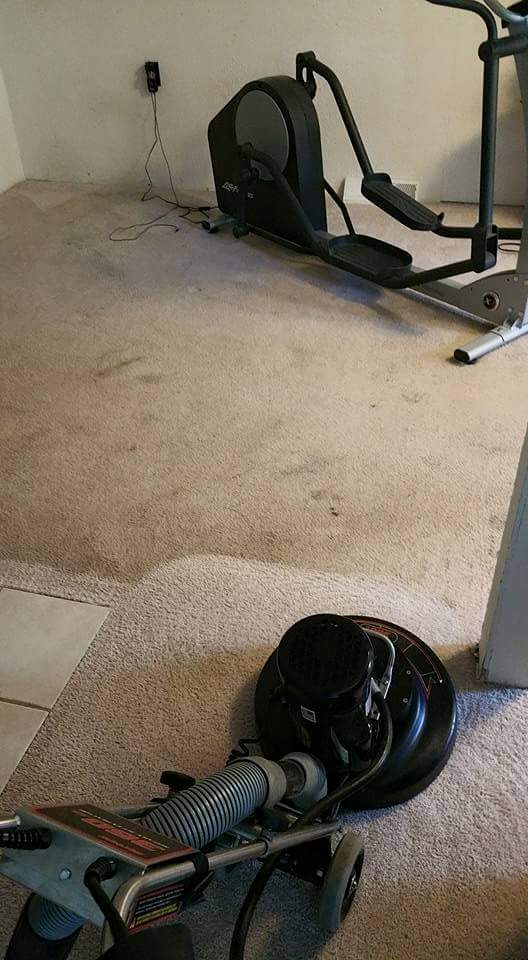

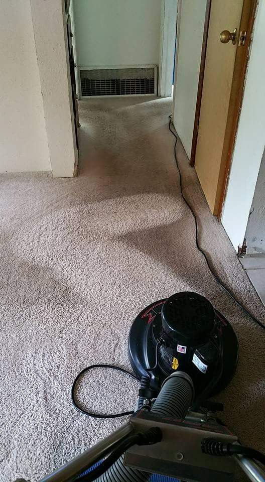

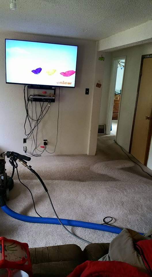

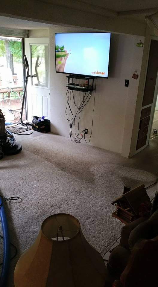

Watching Cartoons and Rotovac 360 XLing....
11,200
Putting these up for the "Boy Wonder" son in law of mine....Aron Jewett
Yesterday....I left him on this project while I ran to another....
He did get some work done with the aid of the Rotovac 360 XL while he was watching cartoons
Harvard special Saiger blend for the sauce....
