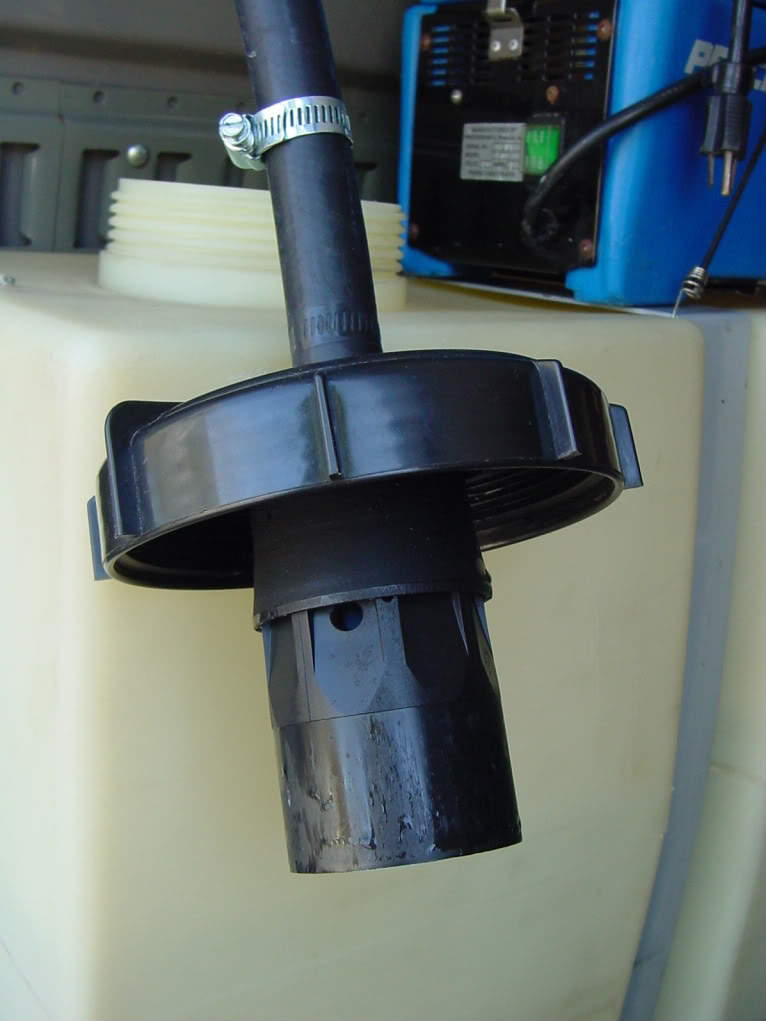

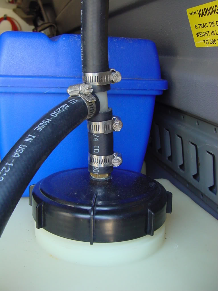

I just installed this 1/2" Hudson valve in each of my 60gal saddle tanks. I used a brass 1/2"npt x 3/4" barb fitting along with the 3/4" agriculture hose I bought a the farm store. I'm real happy with it. Fills the tanks to within 1.5" of the top. I bought mine through McMasterCarr for $26.45 each.
