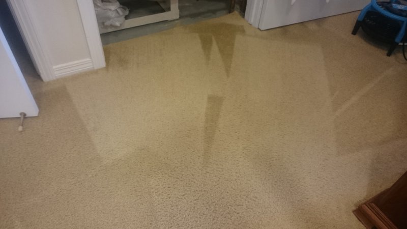

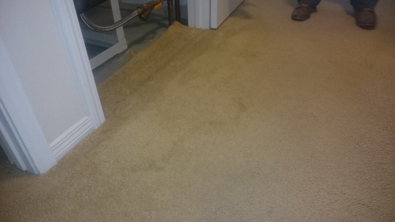

Here is a before and after..
12,576
Deal with the boundaries first, to remove mineral concentration.
Use an acidic tannin and/or urine spotter. Think of the minerals in the water like scale in your truck mount. Just as an acid descaler breaks down the mineral build up in your water system, one of these mild organic acids should be sufficient to break down the minerals that could be causing that stain.
Apply the acid treatment, rinse it well, and just in case do what Scott said and apply an encap product that prevents wicking, like Encapugard by Bridgepoint or Anti Resoiling Agent by CTI/Proschoice.
That should take care of it for you.

I cleaned this home late February..
The water damage happened sometime soon after that. (I didn't know about it until last week) but by this time they had the padding replaced. So I cleaned it last week again.
Interestingly enough, nobody seems to be able to tell me when this leak happened. I just know it was after the cleaning I did in February.
Doc, look at the before and after above. That's what it looked like last week when I worked on it.
Right now, it's less visible than on the before picture...
