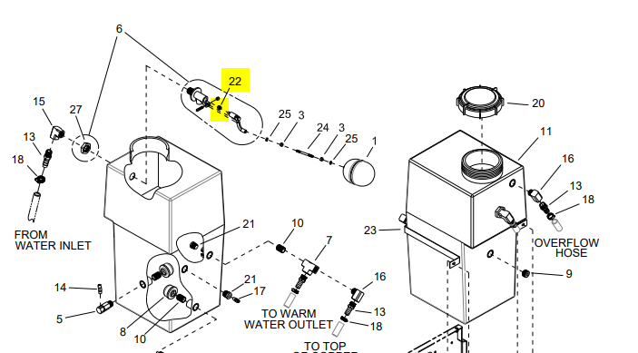

3 reasons:
1. Water in the float ball (most likely not otherwise it would be happening all the time)
2. Brass float is just worn out (possible as it is brass)
3. Float seat is bad (most likely as this is just rubber)
