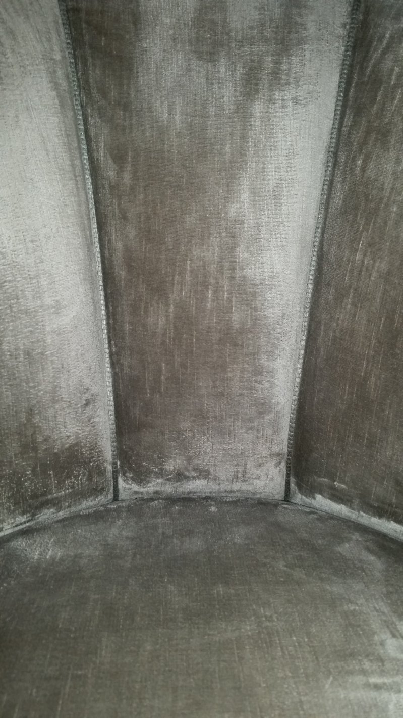

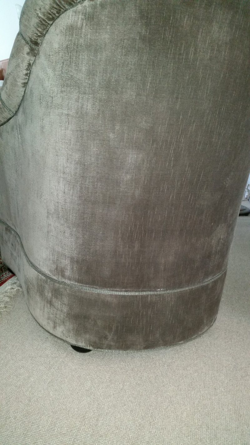

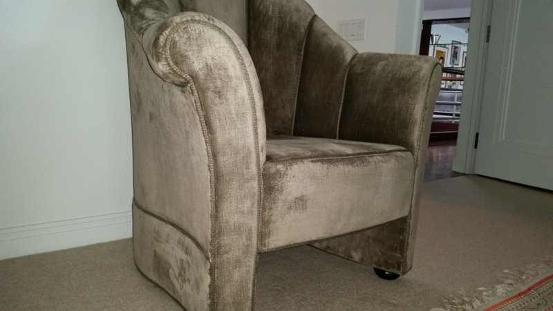

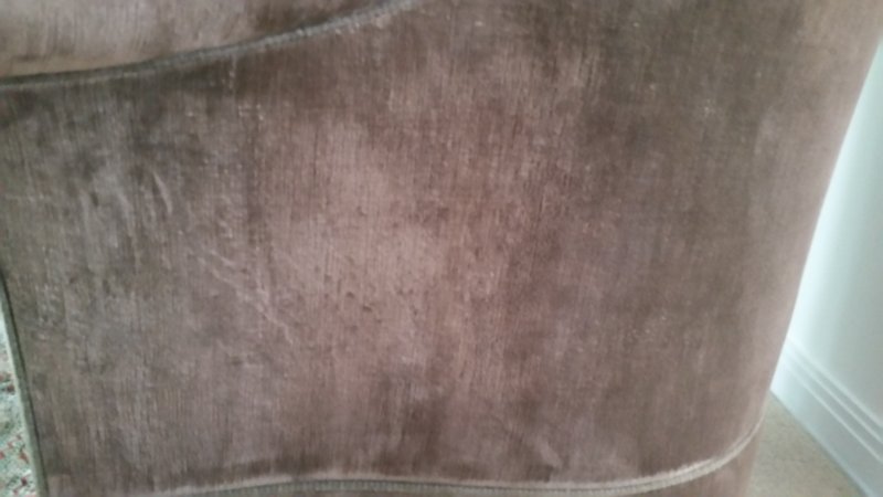

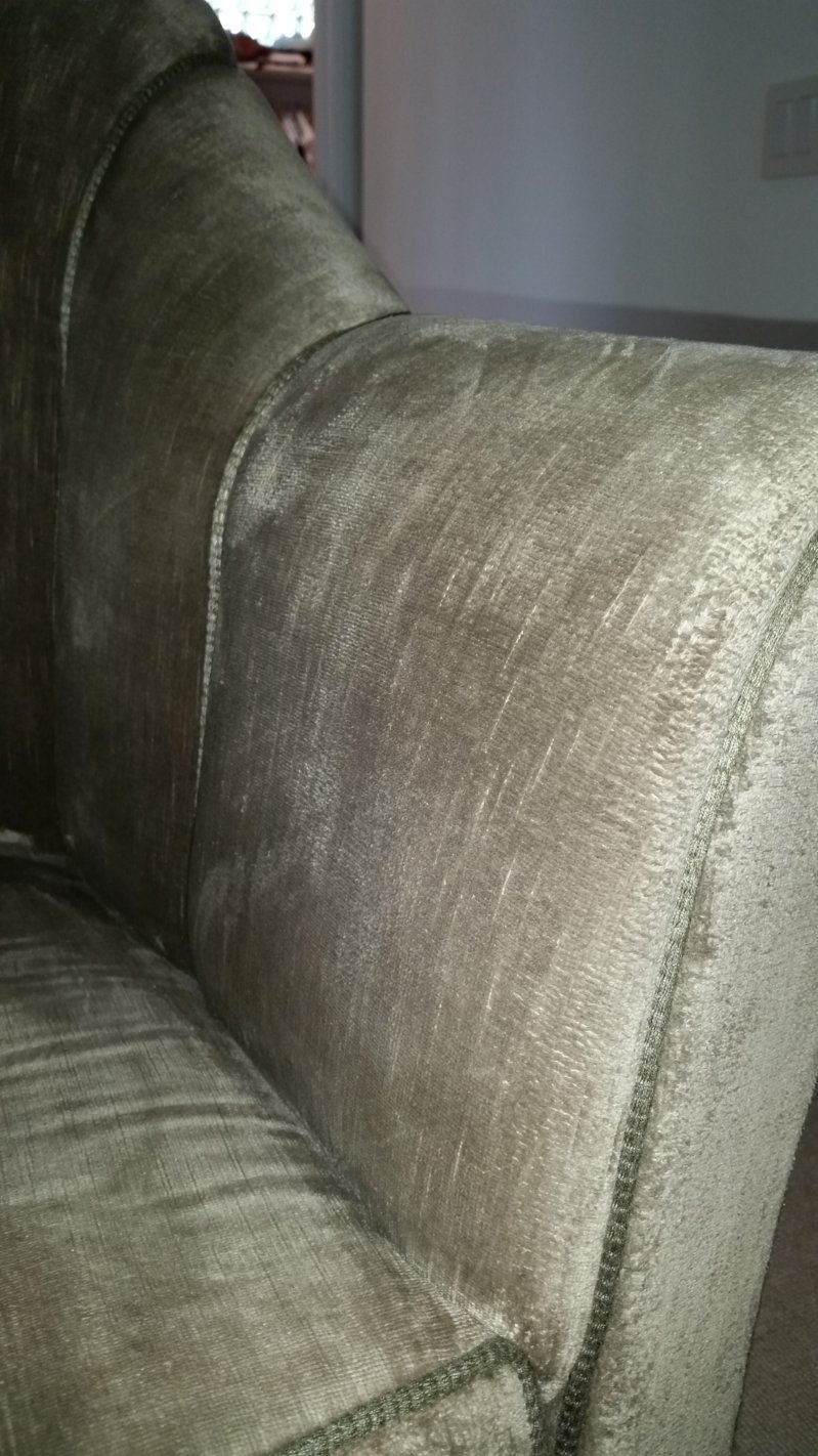

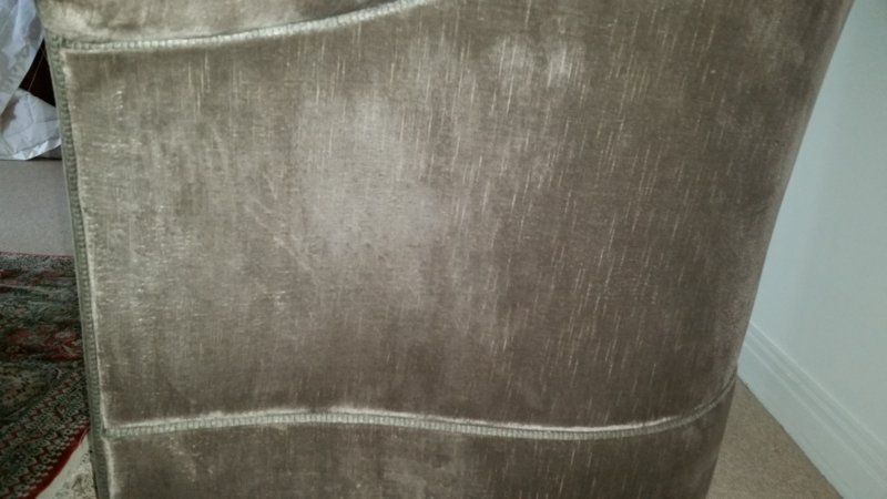

We used a low moisture tool to clean this fabric. The crew did not groom it properly and left it "nappy". The customer also claims that the color is wrong and that it is supposed to be the darker color you would see when you brush the nap up.
We have tried to brush the nap all up and it looks wrong. Any thoughts on how we deal with this?
12,584
The first part is too late: Anyone owning a natural fiber velvet or chenille needs to be advised of the fact that there will be some texture change after cleaning. Grooming during the drying process minimizes the appearance of texture change.
With what you have now, the use of a steamer and grooming should restore the velvet to nearly the condition that they expect.
What they will accept will have a lot to do with their own nature and reasonableness.
He took the words right out of my mouth. :winky:
When wet you control the pile direction so its very easy to make it lay wrong (a different direction than it was prior to cleaning) in the clients opinion.
I think I'd rewet the panel and try grooming it to the side towards the front. Some pieces down all ways look right up or down but have abetter look and lay when groomed across.

I get tired of explaining to customers That the "color" of something is also determined by the angle at which light hits it. The "hairs"/fibers are just laying in different directions. The shiny areas are where the fibers are laying flat away from the viewers eyes and have less shadows viewed from That direction.. Stand on the other side of the pieces and the Shine will disappear. If the fibers are brush up, then the natural "crush" and randomness of the fiber lay will return with everyday use.. Our process, even the grooming is a "mechanical" process such as combing your hair and will leave some "lines" which are unavoidable.
But just as Jim mentioned it is never exactly as as it was prior to cleaning. It will be acceptable 95 percent of the time but those 5% could sting you if they are picky and are not understanding. That's why qualifying spots on new upholstery is so important.
