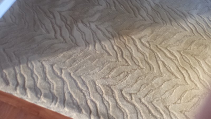

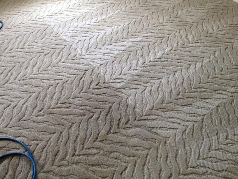

I haven't seen this style before. Cut and loop.
116,877
how hard did you have to lean on the wand to get good extraction out of those valleys?
Reactions: Jimmy L
Willy P
Oct 2, 2007
10,952
Willy P
Dry by the time I finished the house. 2 Omni fans and a dry pod. I wasn't taking any chances just because of the rolling hills.

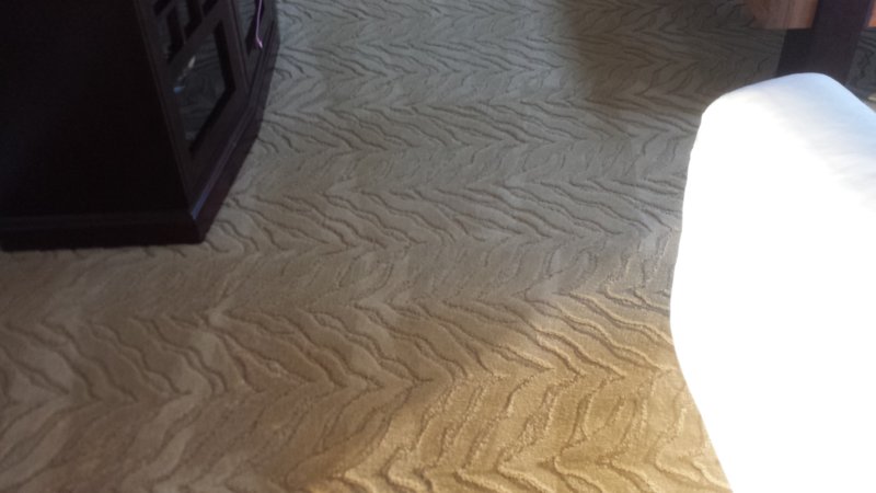

I know that piece: Cleaned it as well!

300 psi, not too much prespray, double rinse and triple vac passes. I had to shine- it was a supplier's house that gives me thousands of dollars in referral work. Full on dog and pony show :biggrin:.
