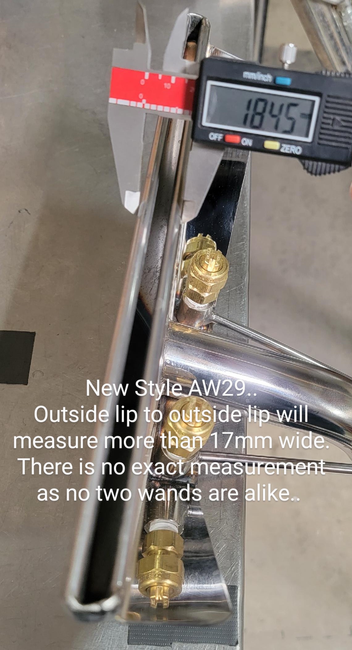

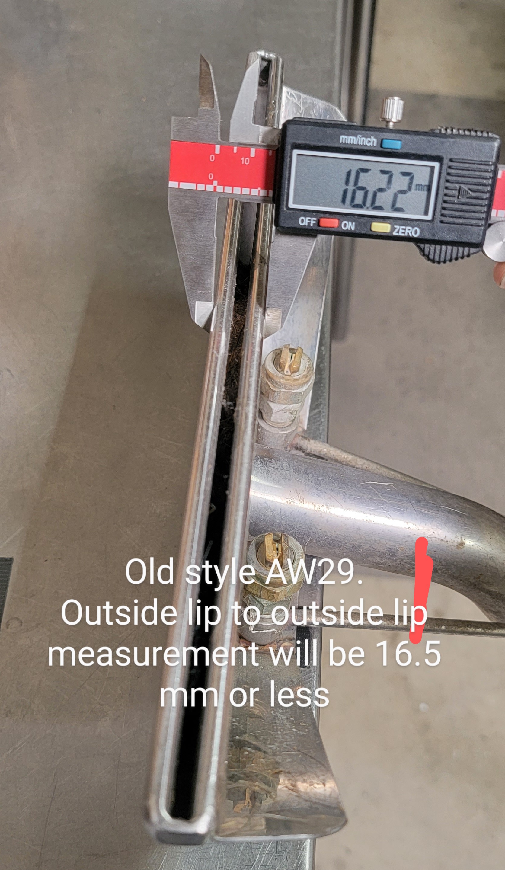

I wanted to put our Glide on this newish AW29 today to do some carpet cleaning and there was no way it would fit ...After a hundred phone calls, I figured out within the last couple of years the AW29 have gotten substantially fatter...
So now I get to make two glides for this turd but it really leaves me wondering how in the hell people are getting our Glide on the new head.....

Can I ask all you AW-29 owners to take a measurement of the outside the outside lip measurement, at the center of the wand, in millimeters please....
15mm
across in several places end to end it varied by 30 thousandths
from 0.580" to 0.610"
.610 converts to 15.494mm

Well **** me again, humblievable..
I showed Lisa those pictures and she says "Mike, neither of those two are real AW-29s..."
Lmao.
Good grief.
I won't blame the person that sent me that telling me it was but good Lord I'm glad we figured this out before I made 200 brush glides for it.
