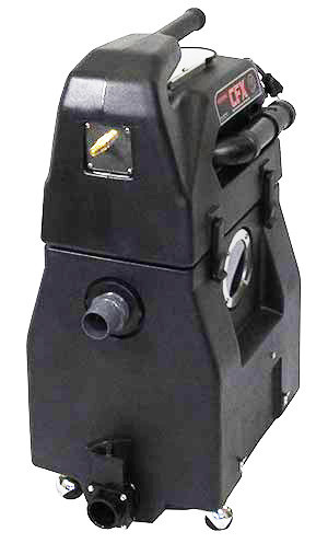

Seriously consider the Rotovac CFX-15
15 gallon waste tank with auto pump out.
Don't take my word for it, check it out:
  • Non-stop high flow cleaning
  • Auto pump out at 2.6 GPM
  • 15-gallon tank
  • Patent pending air and water separation system; no de-foamer required
  • Dual 2- or 3-stage high-velocity vacuum motors, 200 CFM
  • Saves on time and labor
  • Quick and easy dump valve
  • Only 39 pounds!
  • Fits in any vehicle
  • Includes
  • Faucet adapter kit
  • 50’ and 25 foot’ solution hose
  • 25‘ vacuum hose
  • 50’ foot pump-out hose
  • Dual jet S bend wand
:yoda:

Stephen, we can work out a good deal for you on the CFX, since we've recently become a Rotovac distributor. Give us a call if you're interested. :)
