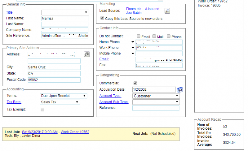

My guys did this one yesterday as well for $2800. The trade school has had a slow down in attendance so they went almost three years with out having us out. Look at their account recap, all but one time w'eve encapped it in one way or another. Hose runs and noise prohibit HWE.
How much have my guys and I learned from an account like this?
think about it.... We've been doing it since 2001........
