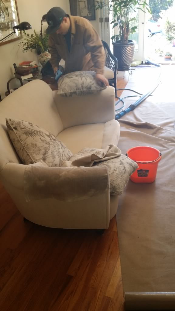

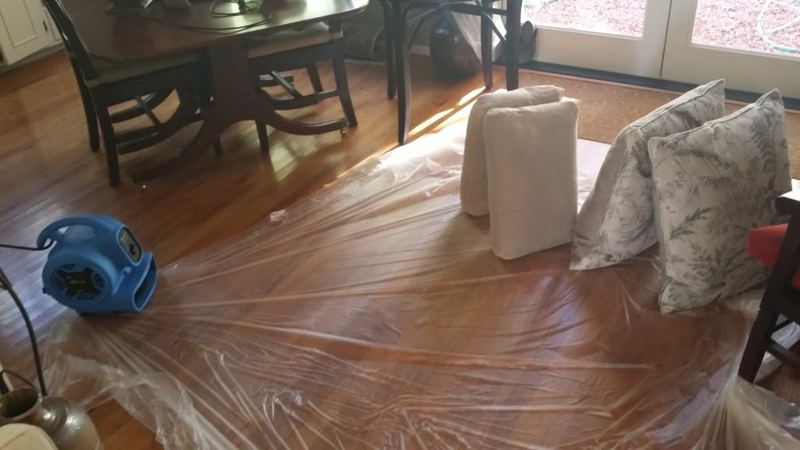

We always have a roll of Home Depot pianter's plastic on board as well. Safer than a customers bed sheet to prop damp cushions on and cheap enough to leave behind. $24.00 for a 12 x 400 foot roll
Great for leaving under rugs that you hacked on site as well.

I think my most valuable item is a folding/height adjustable table.
This is a blow-molded top that when opened is about four foot long, so a chaise cushion fits on it nicely.
The legs have three height adjustments, second level is good for me.
I'll be using it tomorrow so will posts a pic of it then.
Reason I like it so much is because it saves my back and looks so much better than cleaning cushions on Madam's sofa. :icon_razz: :lol:

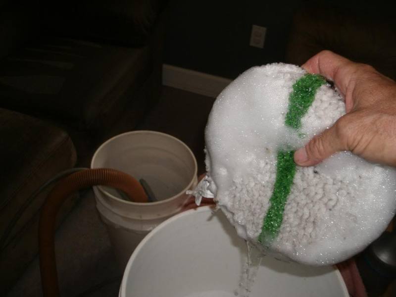

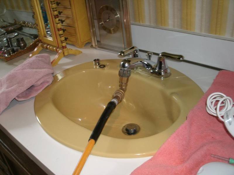

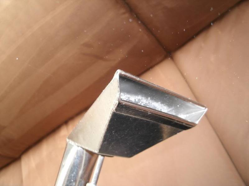

My PMF tool is continous flow because the trigger was removed and the water flow is adjusted to stop at the vacuum opening for little to no overspray:25hosecartporty110_zpse22bffb8.jpg
That keeps the water hot whether I'm hooked to the TM or the custy's faucet:25hosecartporty065_zps4c246242.jpg
I take the vac hose off and fill two five gallon pails with the running uph tool, one for foaming on with a hand bonnet and one for rinsing/cleaning the bonnet. On the vac hose I put a vacuum cuff to prevac then extract the misted prespray that has been scrubbed on with the foamy hand bonnet:beachandworkaugustandseptember077_zpsfa243492.jpg
Then I put the vac hose back on the PMF to rinse the fabric:picturesforwebsitefeb024_zps1d441ad8.jpg

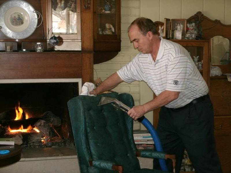

O.K. Art, now fess up. Do you wet clean over the buttons of that chair?
Mike, how come you did not get Art to give a class about efficiency. He always have great ideas. I want a ride along with Art.
And dressing.
Hell, after the first half hour I look like something the dog just dragged in :winky:
A white shirt!
For heavens sake, Art, how do you do it? By the time I've fastened the seat belt it ain't white any more.
What's the secret?

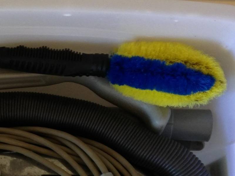

Get one of these.
It's a mag wheel cleaning brush, very soft and has bristles all the way around its' circumference. So you can use it at any angle, full 360 degree agitation.

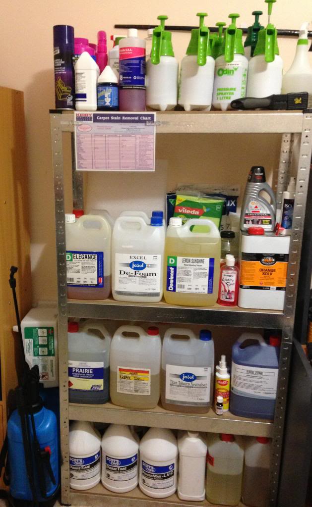

The next thing you need is good chems. Not 1 bottle of something, but a good solid suite of chems you can use to solve many different problems.
with lots of chemical treaters you always have the right thing to use and can avoid the situation where you're trying to use something that is ill suited or a compromise.

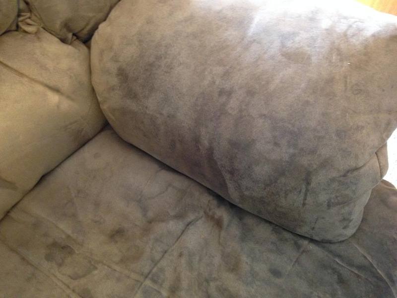

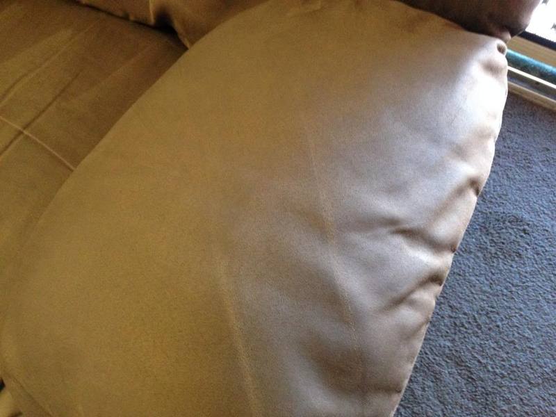

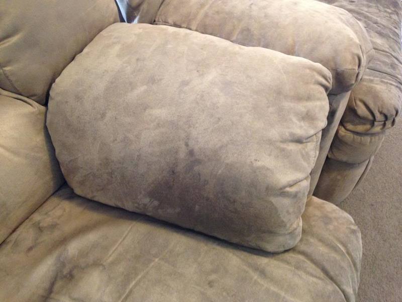

This is an example of two such jobs I've done over the past few months.

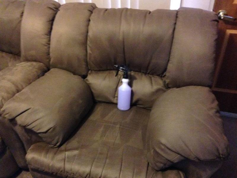

Now it has been sprayed with Aussie Encappa, a locallly made encapsulating multipurpose fabric cleaner. It can be used as stand alone encap cleaner for carpet or upholstery or as a pre-spray for extraction. I have solvent spotted the pice and sprayed it generously with the Aussie Encappa. Scrubbed it well with the mag wheel brush and towelled it extensively. Out of the frame there is a pile of 12 cotton towels and they are just black with soil.

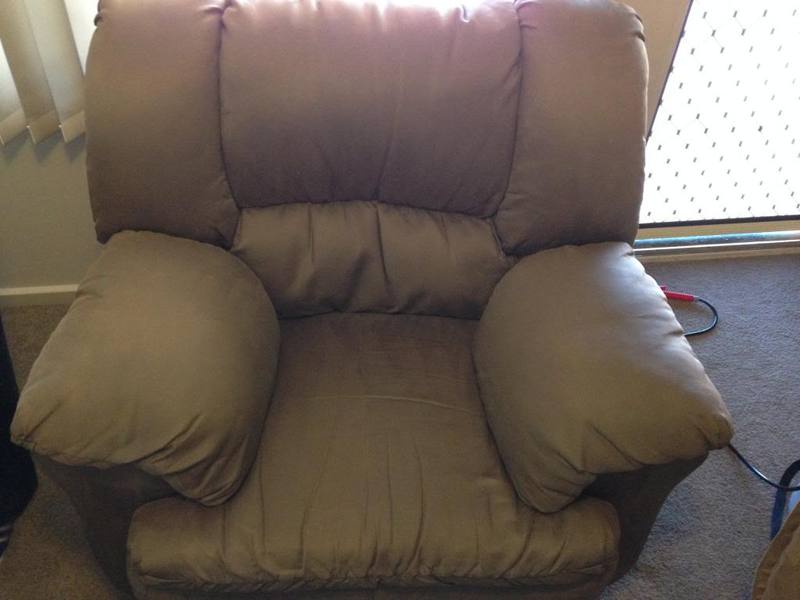

Now after hot water extraction
Remember to leave your customer their free gift on the piece to marry together their surprise of the result with the bonus of a freebie.

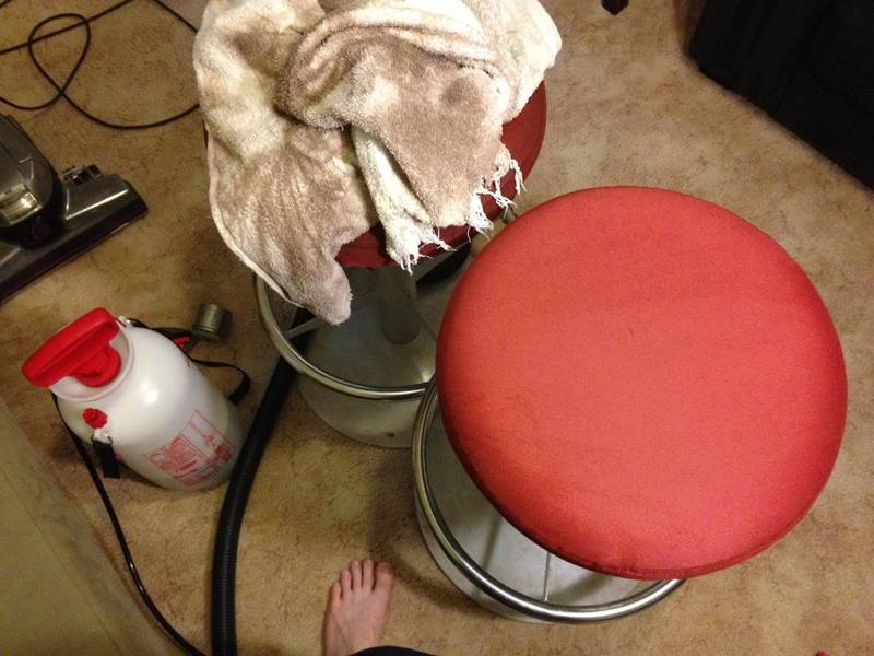

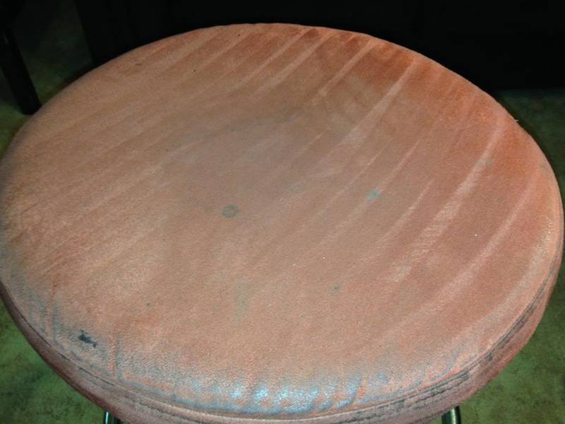

Same story here, it's just this one is a bar stool from a tyre fitters garage. In Australia we have a national franchise of tyre and wheel garages called "Beaurepairs". Their corporate colours are blue and this RUDE shade of orange. I was in my local garage getting some tyres. The guys andI were negotiating a package deal for him to rotate and ballance my wife's vehicle's wheels and to to some camber and castor adjustments to the front end.
He said how much he wanted, I said "what about I clean these stools up for you, they look really sad and that takes away from your customer greeting area's appearance a lot?"
He said "IF you can clean them, and actually make them look good, we can just exchange services".
Didn't bat an eyelid, just loaded up 4 stools and took them home overnight. Using the same chemicals and process as before this is what happened.
After vacuuming they looked like this......
Some solvent spotting, pe-spray, extensive towelling and extraction they came out like this.
And after some post extraction towelling they finally arrived back at the shop like this.

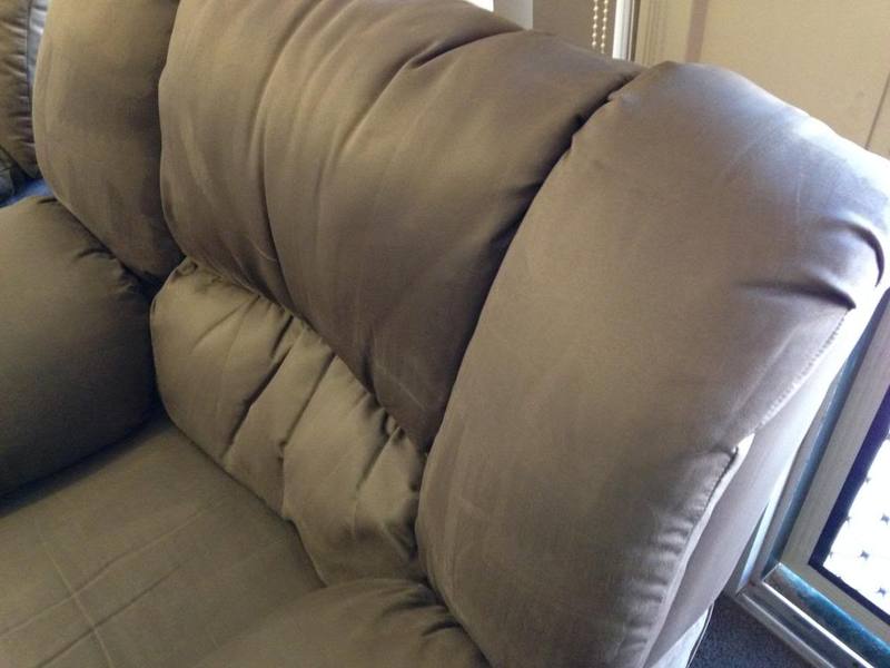

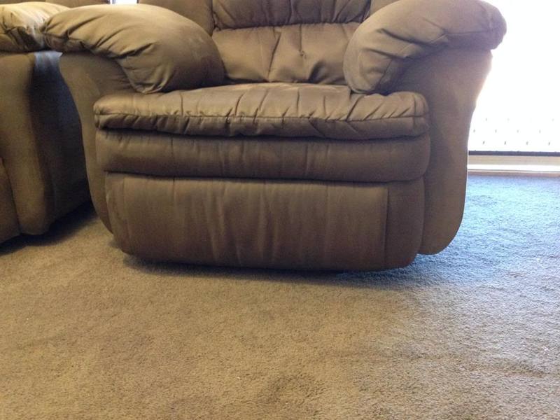

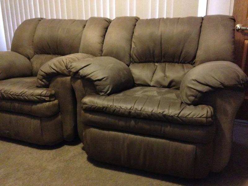

I had a similar microfiber stuffed chairs (2 pairs actually), it was red, and just trashed...tool of choice prior to extracting w/ SS uph tool was my makita 9227c w/ a beige (fiber pad) soaked into solution, twisted it just slightly to it doesn't splash everywhere, towel after hwe, and fans. It looked very similar to the red bar stool pics posted above (great work above btw).
