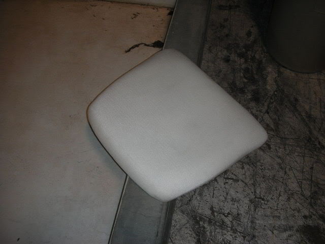

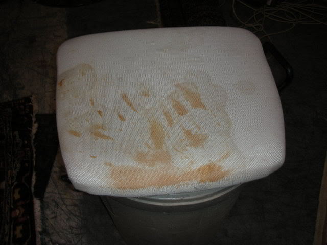

How does this look?
let me know your fav chem for upholstery and what you think?
i used Masterblends Soap free and boosted it with boost all. sprayed on with trigger sprayer. dwelled 10 min extracted with fab set.

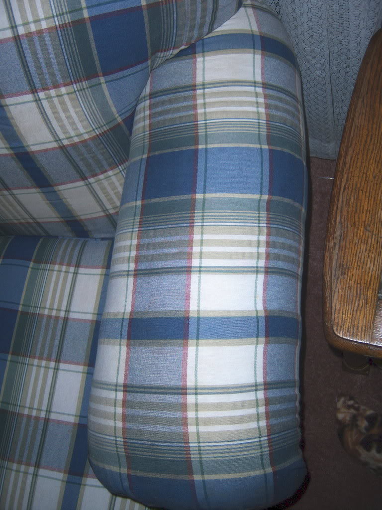

i added it as directed on the container. worked well and i also tested for bleeding and color change. think i'm slowly getting the hang of this.

Looks good.

Pics look great. Hardball power-pak is a good cleaner and is on the acid side of the pH scale. Very safe to use. Rinses out well with power- powder or you could use Judson O2 rinse.

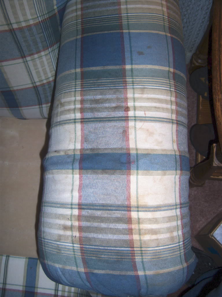

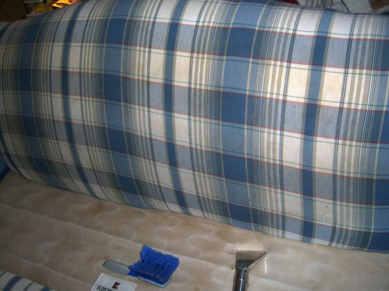

1 gallon warm water..
8 oz of Fabric Shampoo...
2 oz of Boost all...
2 oz Citric solve ...
spray on and scrub with a brush and extract...save on a lot of uph and very effective.....

yep...i did a white rag test on it before I even started the job...........I thought for sure it was going to be a bleeder but it was stable and gave me no problems at all.....
