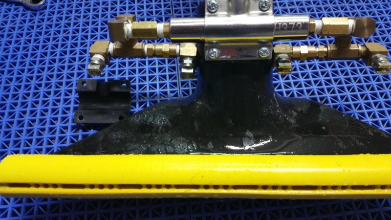

The correct jet size will depend on how mytee built the mana fold in the 1st place-- mytee substitutes parts at its whim.
The stock jets and configuration left streaks in the carpet because the jet were too close to the carpet. With some effort I was able to change the configuration that raised the jets and seems to work ok-- but too soon to tell.
Removing the shim and adding a glide also helped.-- try this before changing the brass.
The photo shows the change.
