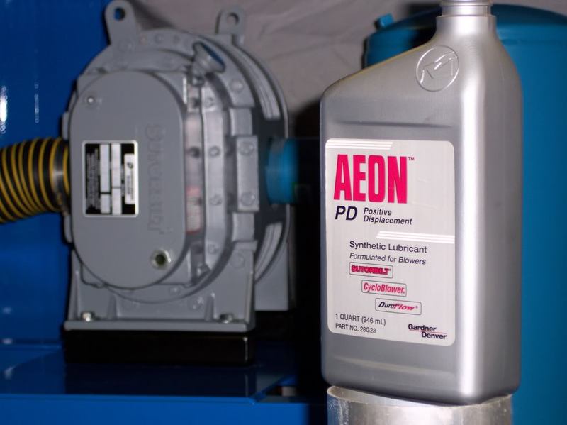

What kind and weight of oil do you use in your blower?
May 12, 2007
2,242
OIL
BOB
If you have a old blower like 10 years old you can use 30-ND motor oil.
If it's a newer blower use this oil in the photo.
THANKS
LES
