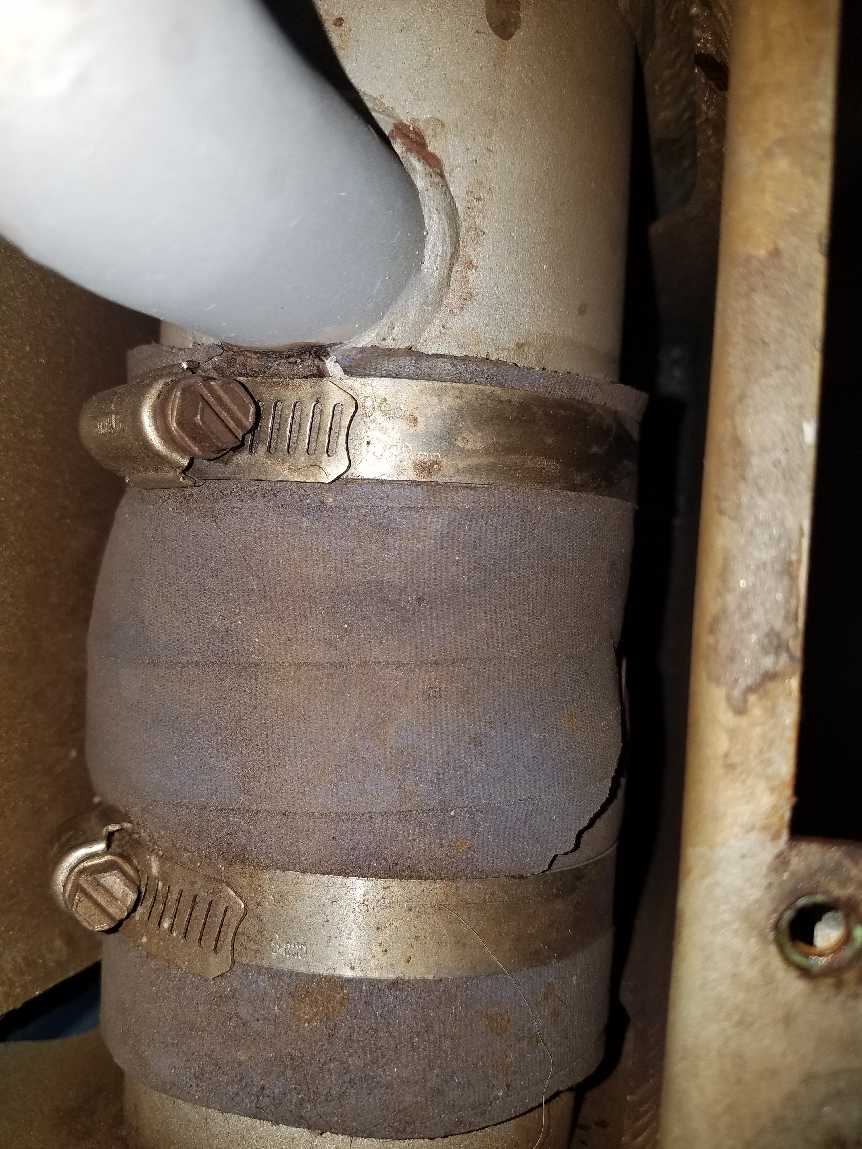

What kind of hose is this(blower to hx)?
jcooper
3,232
IL
Jerry Cooper
Is this the same type of hose?
Blower exhaust goes through it to the HX. Sapphire list the hose as "HOSE, FLEX 3 IN HIGH TEMP" part number #16-035.
Raising and lowering the blower(belt change) maybe ripped it... Not sure.

not sure what tore that hose Coop (they're damn tough from my experience )
Have some suspicions it from jacking up blower off a stuck on hose.
Clamps off, the thing is still "stuck on" pretty good
If that shoe fits, get a bigazz set of Channel-Locs and in the future grab the hose and give a little twist at top and bottom to break loose the crud/heat bond that always occurs
Yea, my mechanical skills are most likely what caused the issue!:hopeless: Had to replace the blower belts(first time for me) and was having issues after(no suck - posted a month ago or so about it), kept thinking it was blower and kept tightening the belts. Ended up pulling the hx tube up higher than the other tube. Bet that's what ripped it.
