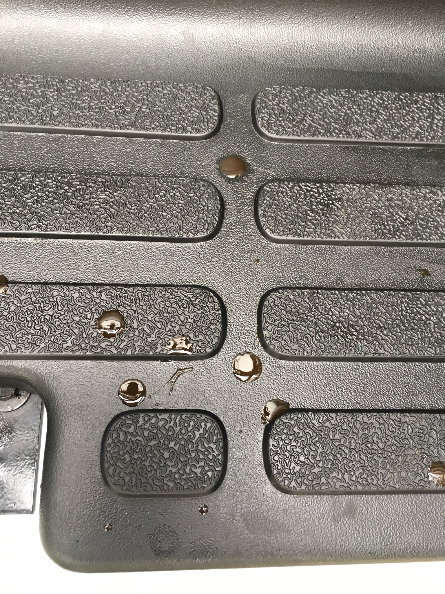

This is coming out of my exhaust from my truckmount...every morning before firing up my unit I find these drops. They are oily when I wipe up with a terry cloth. Does anybody know what this is and how to stop it from keep happening, thanks.

Oil coming from the crankcase ventilation breather. You may have a hose that comes out near your carburetor/airfilter assembly.

24,146
I get this from time to time, especially when my waste tank gets too full. That water gets sucked through the blower and out comes the gooey goodness.

15,253
Thats what I thought Fred about the wd-40 blowing out.
I'll even have that come out of my blower exhaust from my pto

Can you show a picture showing more of the unit front. Those drops look like they have fallen straight down onto the step. If it came from the exhaust it would look more directional.

Now that you mention it...it only happens when unit has cooled off and being sit over night.
