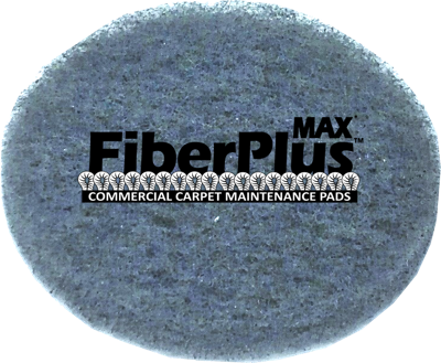

The FiberPlus Max pads are what I'd recommend. They're PERFECT for filthy CGD. They scrub efficiently, yet they're safe for commercial loop carpet.
http://www.excellent-supply.com/Fib...mpatible-with-19-inch-Cimex-Machine_p_95.html

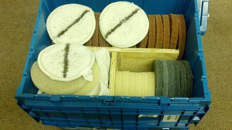

We use Rick's Max gray pads and they work well on heavy soil but when its really bad and you're using low moisture we use the 8-inch Tuway BBC pads. They really kick butt. The Brush Bonnet Combination pads have a brown strip of aggressive monofilament to breakup impacted areas.
You can wash them over and over, they last forever. One more tool that you should have if you own a Cimex.

The strongest pad I'd recommend is the FiberPlus Max. From there if you need more firepower, you could perhaps go a little more nuclear with your juice. But going for a more aggressive pad could open you up to a damage claim. I recognize that the carpet was probably considerably shot to begin with. But in this litigious society - if you damage their fiber they might still want to come after you. Especially if you're dealing with some pinhead inspector that was hired by the carpet mill.
