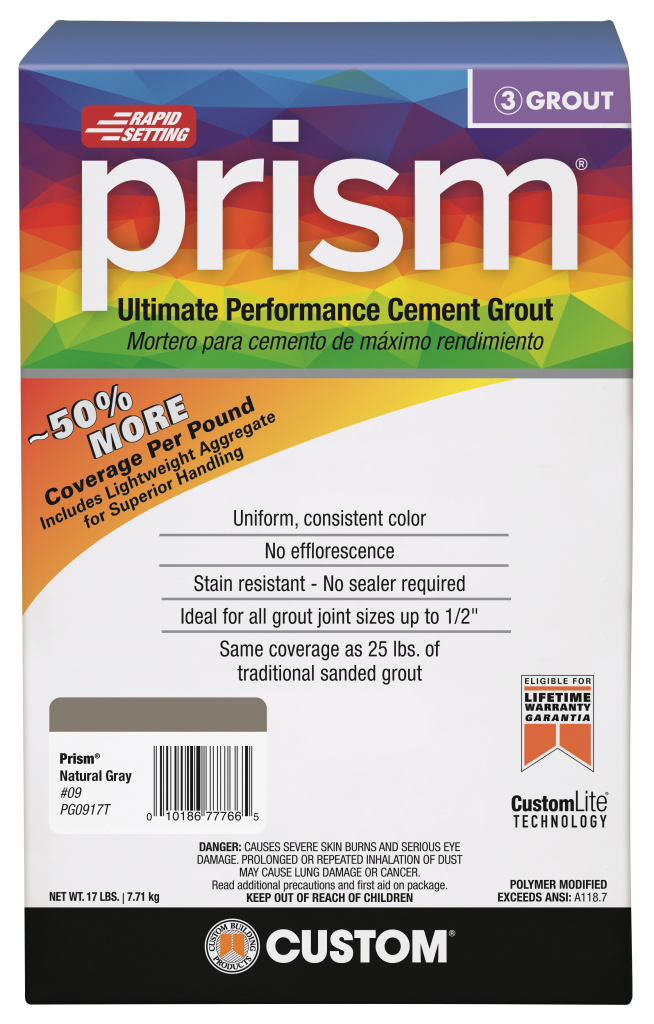

If its not too late, suggest he use this grout for the install.
The color consistency is amazing and the lack of sand will enable easy future resurfacing if desired.
Far more stain resistant too but seal it anyways

Would not recommend Prism, as it may surface damage a polished surface,
Custom has also updated there unsanded line i noticed, unsure, however may be using similar type cements (color fast and quick cure)
