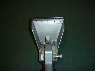

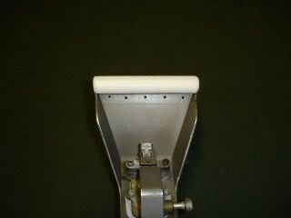

Greenie
6,820
This is the very first one I ever did, if I did one today the holes would be a bit bigger (3/16") and I would only have 4 of them, evenly spaced, it's all you need.
And as I learned from Mikey, and thee monster V , drill them a bit higher well above the glide.
So if you have some really LOOSE fabric it won't tend to get sucked against the holes with each pass, I'd probably put them 1/2" from the steel lip, about where that "seam" is on the tool.
I expect to see this on Joe's next email spam as his newest upgrade.
