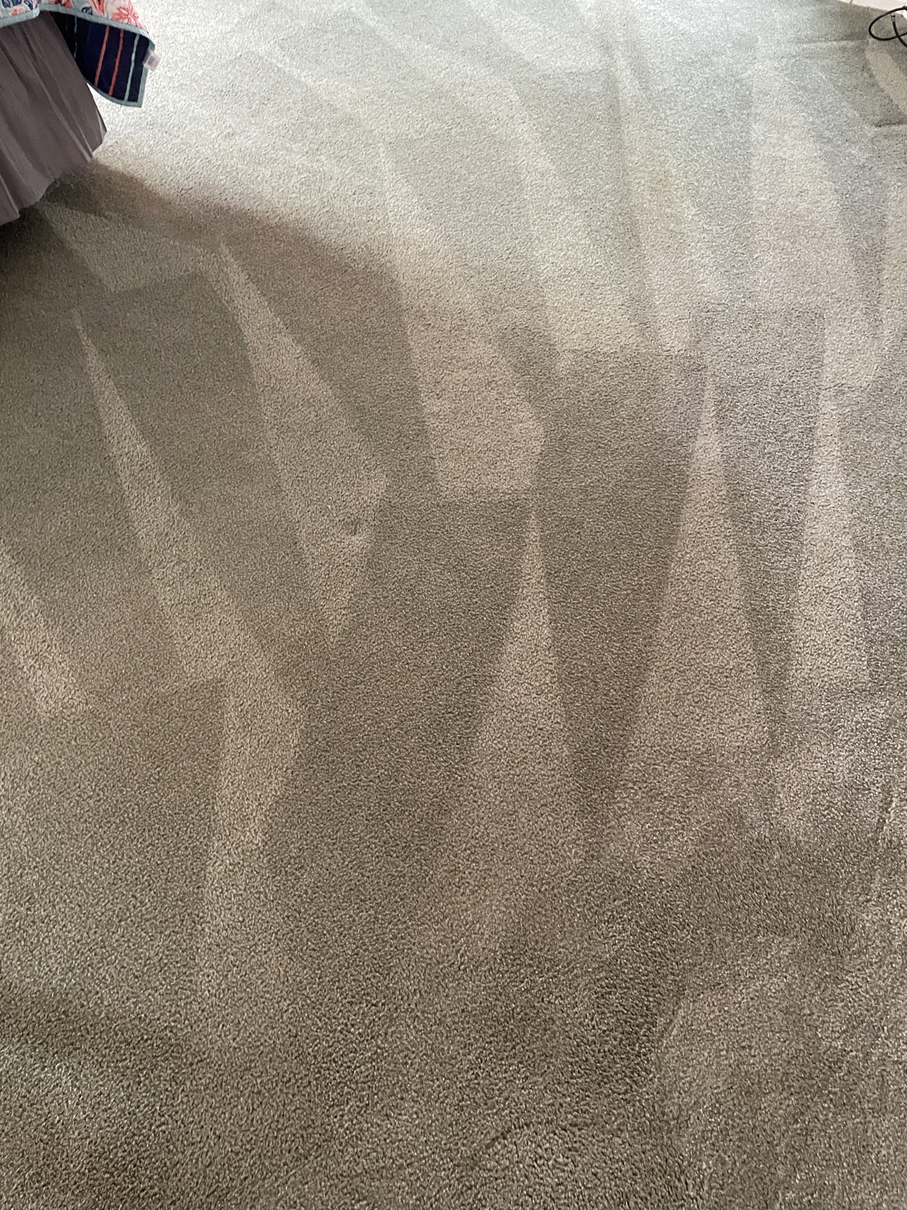

One more time. 30 seconds.
Groomed it after.
Mike J
Feb 21, 2022
1,326
Mike Joannides
I did groom and dry after that pic, didnt notice it with the eye. it was near my exit of the room and probably just the way the fibers are aligned at the time of the pic.

I'll do shark tooth if I don't like the customer, nor care if I ever see him again.
This is a passive-aggressive thing I do for some customers that lowball the estimate-I'll also fill up my fresh water tank at their house. 😱😈
I do multiple dry strokes and still leave teeth. Never had a single complaint. Is it that bad or are some of you just a little over the top.
Maybe I’ll change on Wednesday
7,044
Depends on how many dry strokes.. Maybe the Last dry stroke wasn't needed. either way- shark tooth proves the cleaning wasn't even/balanced for all the fibers.
