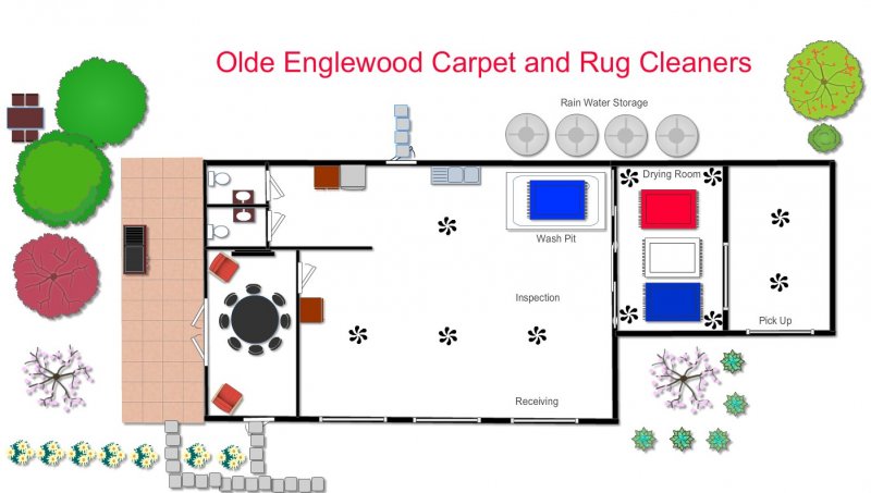

Well I'm meeting with a construction company this Thursday, for the second time. We will talk harder numbers and layout for a small shop I'd love to build.
The first consultation was hard. I really didn't know how big I wanted, or was able, to go. I gave them rough dimensions of 40x80. 3200 sq ft.
The cost terrified me. $220K to $300K, depending on finishes and type of construction. This doesn't include the plot of land. Utilities are ALREADY on site so that helps.
The President of our bank came to the site to meet me and seemed willing and able to deal with us on it.
HELP ME BE SMART. PLEASE.
I'm thinking about scaling down considerably, so I don't have a nervous breakdown before my 41st birthday.
1600 sq ft would be half of that size and allow me some room for 2 vans, a small office, bathroom, workbench, utility tub, and plenty of board du jour tools to keep stored.
What am I missing?
I want it to LOOK sharp too, and give us a nice fresh presence in our small but growing community.

Think about the difference in cost from 1600-3200 sqft. You might want to do this now rather than it be too small later on. Are you planning to clean rugs? Otherwise I don't think you need the space. You want to park the vans inside to avoid freezing.
Reactions: Russ T.
Plan for the future with a design that will allow phases. Build minimal size initially and as your needs expand, expand the building.
4500 sq/ft in 3 phases. Phase 2 can be an area to process rugs.
Phase 3 more garage. ???
A small office and a warm spot for your trucks in the winter are the main concern.

Access from both sides of the corner...eventually.
Concrete's not cheap!
1,846
N GA
BradFenstermaker
Keep in mind resale for the future. I say 2000sqft. Eventually you may want to do rugs.
Frame up the van area walls and ceiling so your only keeping vans toasty.
I am going to propane heat in truck run.
Also have them install drain in van area for washing truck i side. Or dumping cough cough.
Spigot too.

Steel should be half the price.. Maybe less! They make it real easy to get quotes online since they are sold as kits..

Check the municipal regulation on drainage, where and what can go down there, keeping in mind truck washing inside or out and rug cleaning effluent.

For 300000 I would build a multi-tenant structure with at least 3 or more suites for a total of 3-4 total areas all with bathrooms and separate doors but keeping in mind to make it moduler and easily reconfigurable.
You can never have too many bathrooms.
Have your renters pay the mortgage plus.
I couldn't agree more!
13,372
Dude, they build houses that size for less. Get some more quotes.
It all doesn't have to be concrete neither. Not to start with anyway.
You can build a pole building wayyy cheaper and it will still look good. That price sounds like burdick pricing.

Another consideration, build the 3200 but divided into two suites. Rent the other side out until the company needs the sq/ft.
Look for a plumber or electrician that is looking for a nicer place. Sign a 3 or 5 year agreement. Consult your banker, he may like the idea and may even know of someone.
That's what I was going to say. Go bigger and rent out what you aren't using now. Have that rental income help pay for the new building. As you expand and grow you have the space if you need it. If you don't expand and grow you have the income from the rental.
Look in to pole barn construction. Much cheaper and you can still insulate, divide etc.
