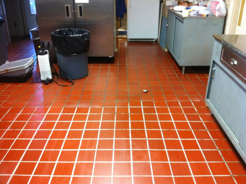

Jeffrey, pre-scrubbing does help but as Marty said, a rotary brush may not get into the grout lines. I have a blue brush that scours pretty well, but it always needs detailing. Find a good cleaner such as Venom Viper, or even Flex with citrasolve (Interlink products) and your life will get easier. Where you use pressure, I use superheated steam. It is slower, but fits my style.. Good luck! "Always, Excellence."

what the hell did you use on that one. looks great!!
Heart of Dixie

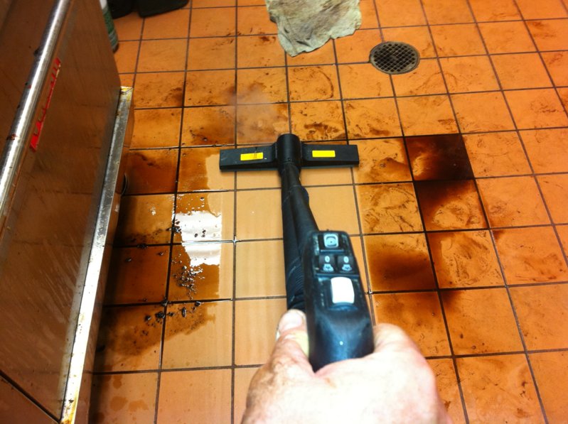

Scott, Thanks. I first stripped wax off of it (!@#¥!!)
Then used superheated steam to boil the lines. The whiteness comes from using a diluted acid wash. Here is a similar floor being degreased and vac'ed with steam:
