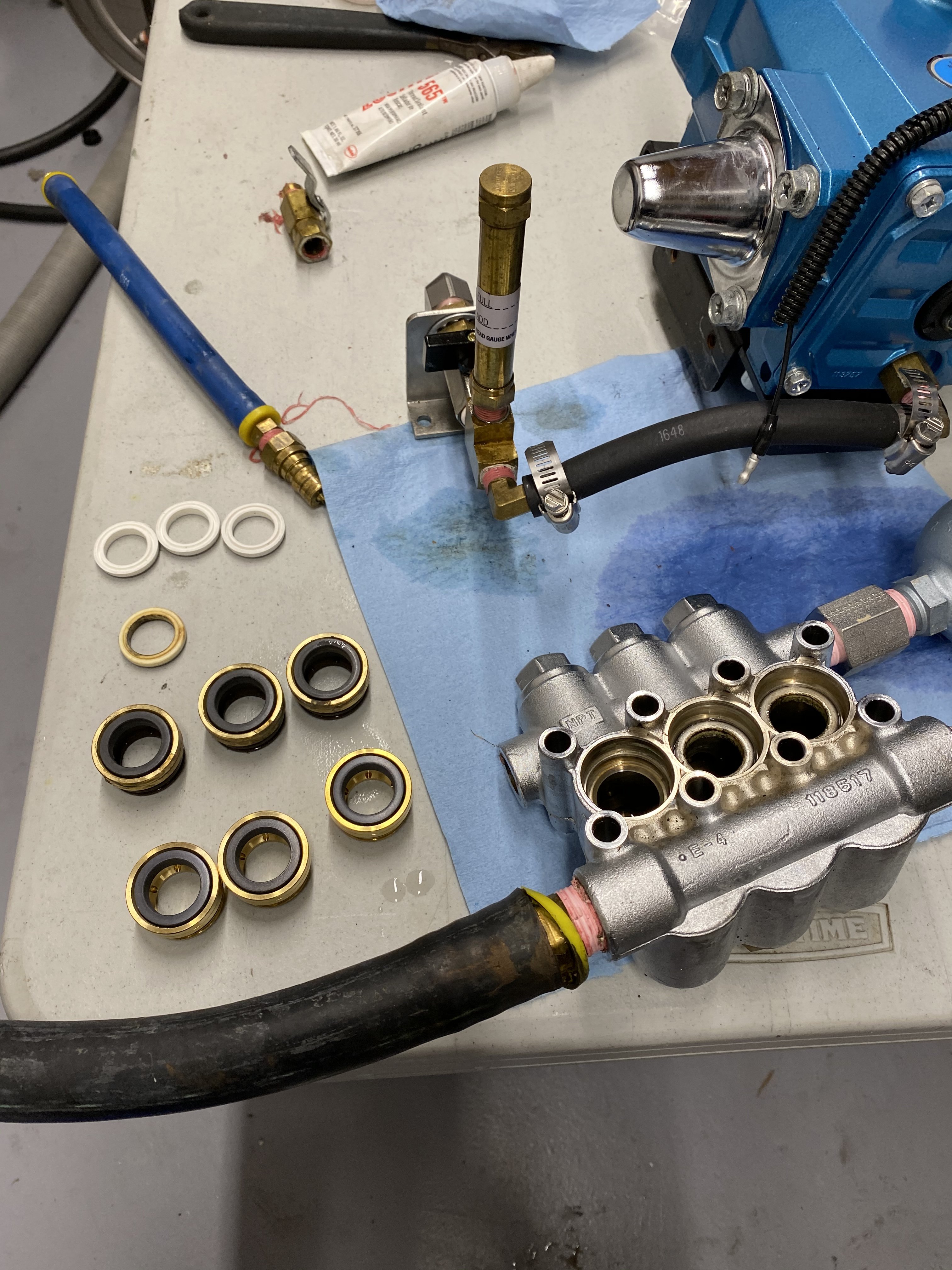

Where can I purchase the new spring and piston chemical pump for the Everest?
14,619
The ball valve on my chemical pump is bad on my 650 and I'd like to upgrade that setup to the new chemical pump on the new Everest 870.
Can someone give me the GP part number for that model?
I'm almost certain it's 101067 but I'm not certain. Can someone help confirm that?
Looking at the manual and searching the prochem part #86191440 seems to yield GP 100906
You can get both the pump and rebuild parts at kleenrite for a decent price (see above PDF)

I’m needing the one that can handle 3000psi.
Ok...sorry..I read the OP again
101067 would be the correct part number...what is on the 870

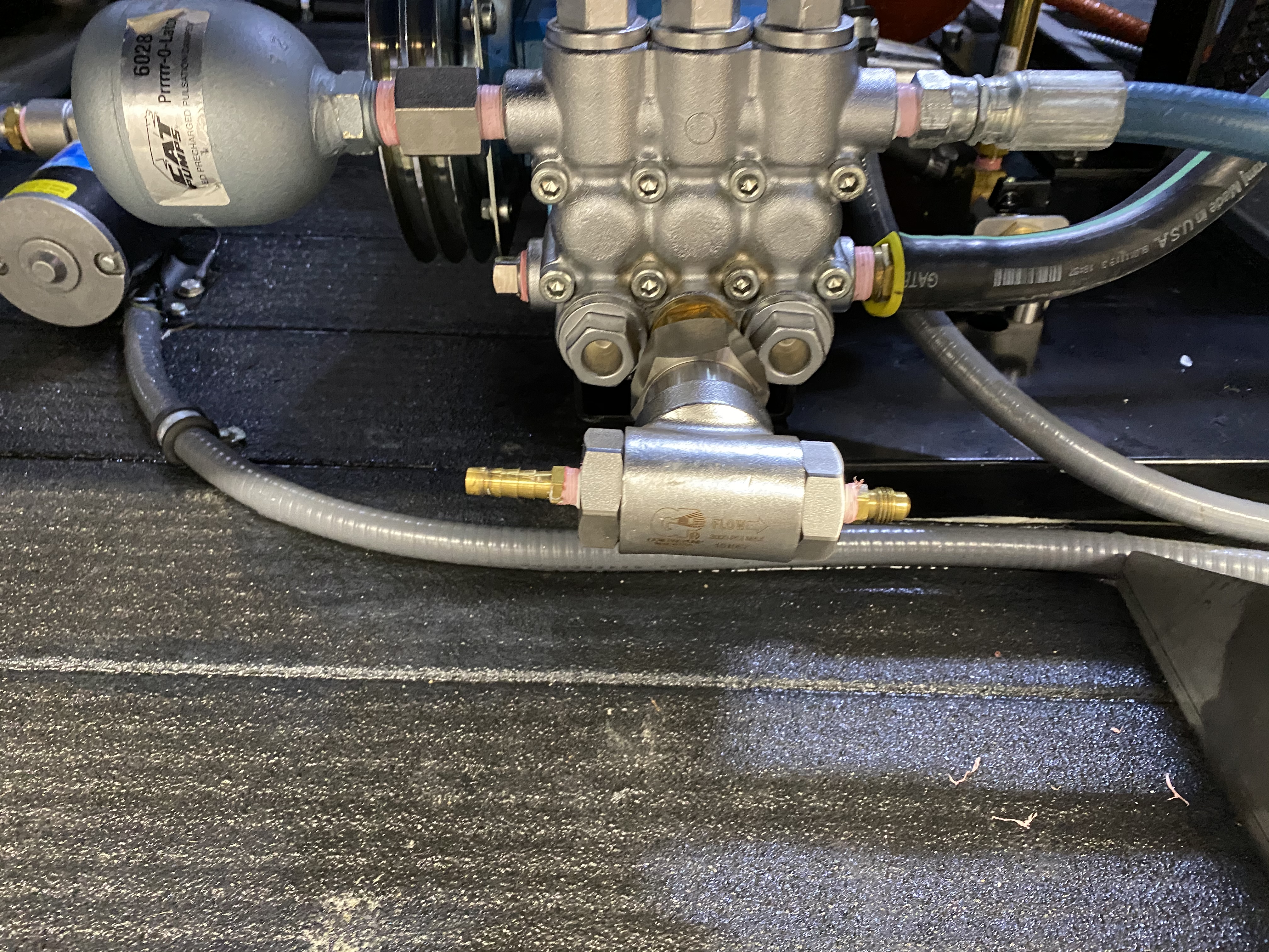

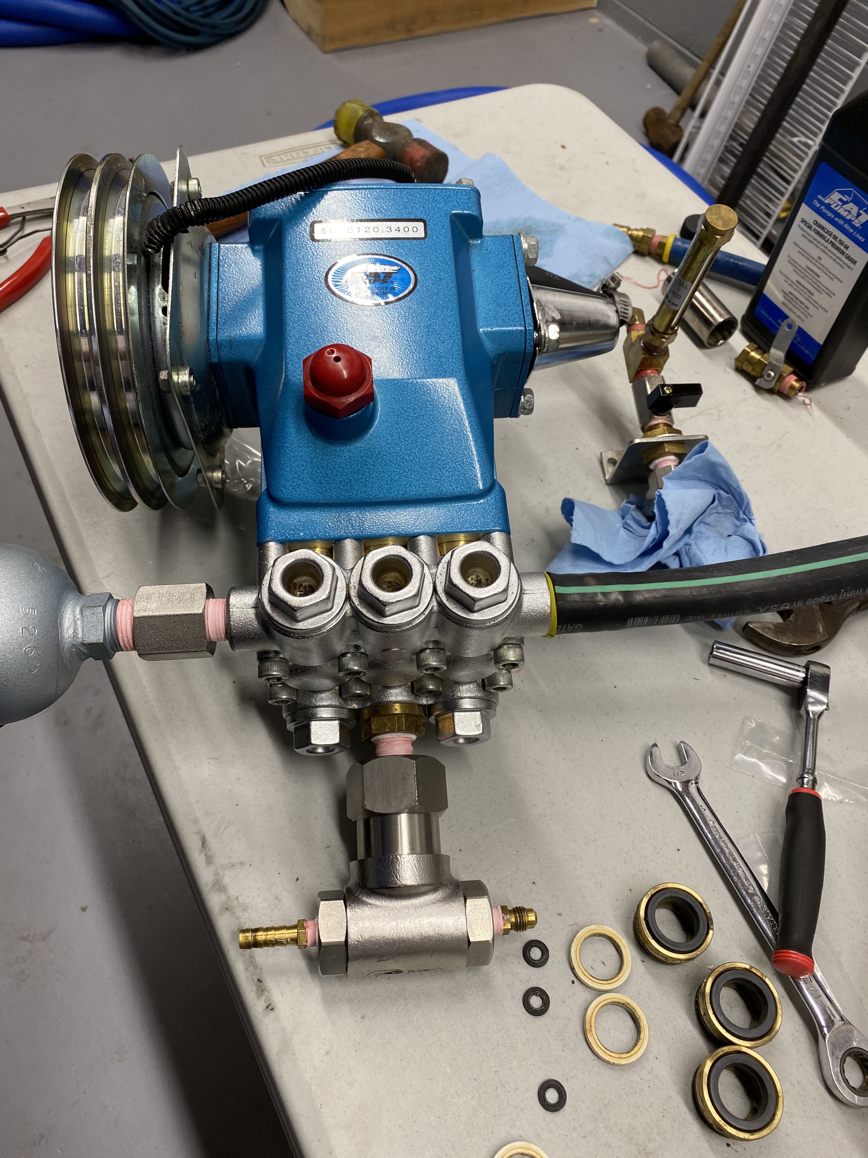

Ordered it from Toolbarn, installed yesterday. I rebuilt the pump and removed the shutoff, not needed anymore.
