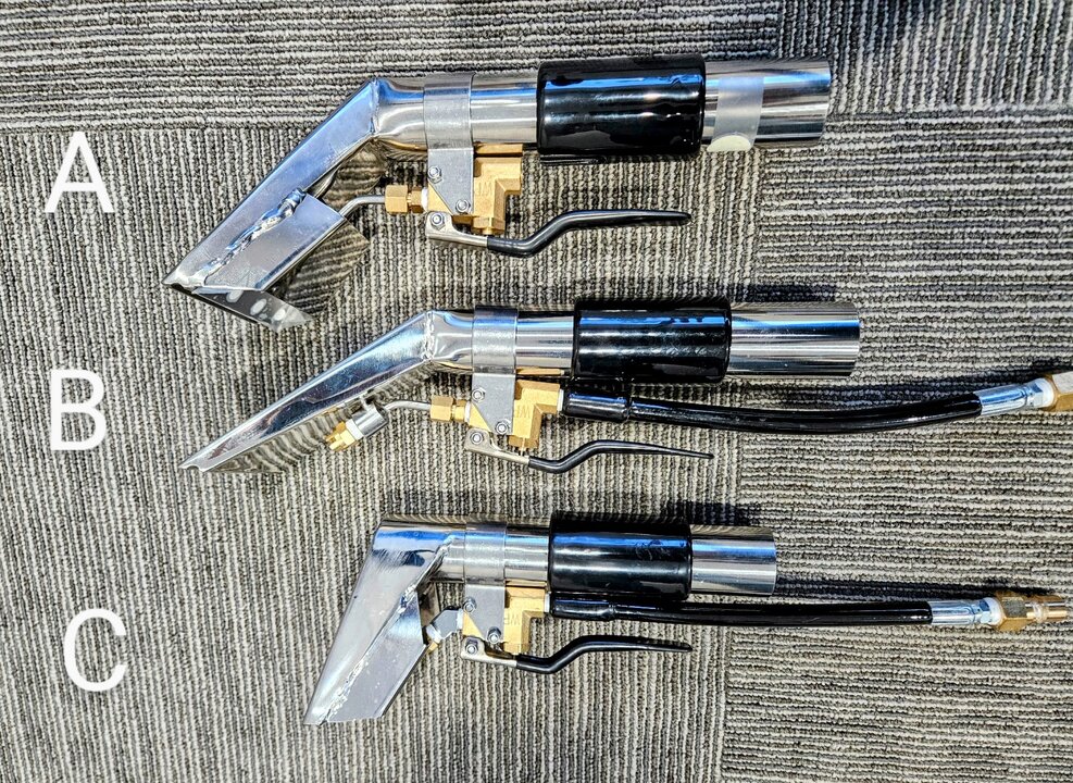

Which of these detail/ upholstery tools is the most comfortable to use?
Most comfy
  • A
    Votes: 0 0.0%
  • B
    Votes: 2 66.7%
  • C
    Votes: 1 33.3%
  • Total voters
    3
117,353
C would be the most similar to the old Prochem cast tool and the new Mytee
B is most like the popular PMF tools.
I'm interested in your opinion the angle of the vacuum chamber.
Imagine the tool as if it had a hide-A-hose installed.

I have a few versions of B but always remove the 12" leader hose with quick connect and put on a 15 footer on to get the disconnects out of the way for more comfort.

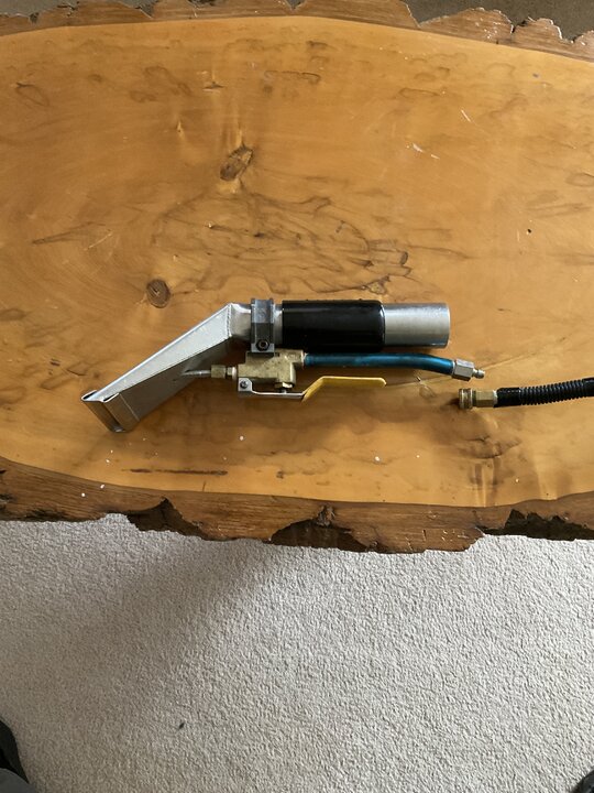

I have a clear plastic head version of B that has an internal solution jet and a adjustable continuous bypass as part of the valve. I don't use it much but i do find it quite comfortable when I do. I also have an attachment likeC i use it mostly for cleaning my vans carpet but my vote for most comfortable is B

None of these are great for detailing upholstery, I don't know what ours is called, it looks like B but the nozzle is enclosed into the snout.

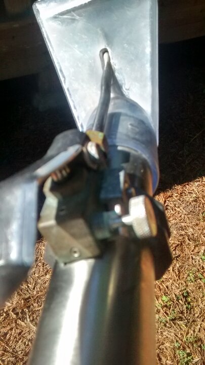

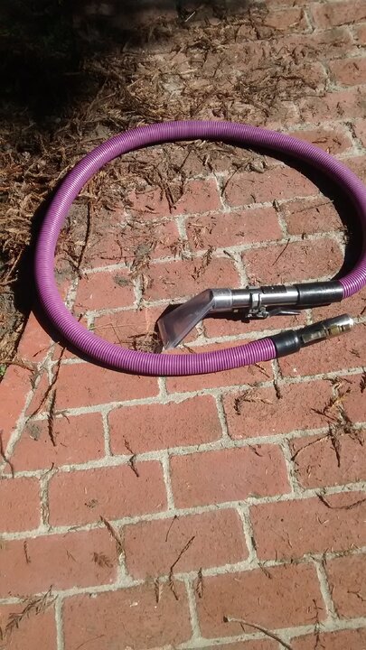

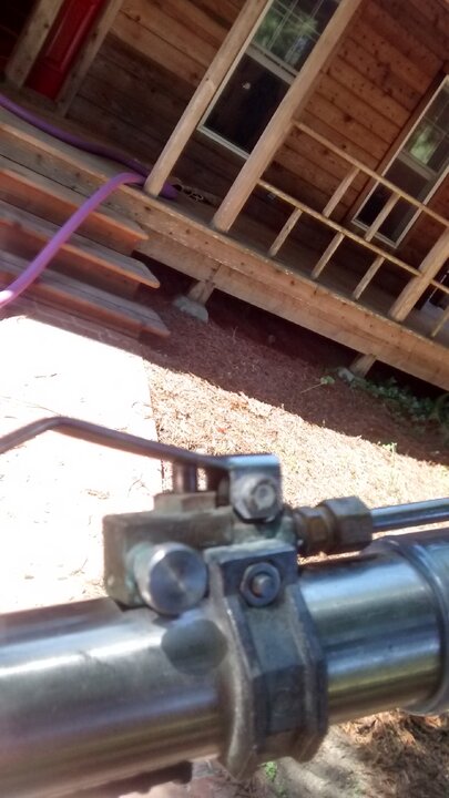

Here is my set-up for my PMF handpieces. I have them in 2” 3” & 4” widths, all interchangeable with 1/8” stainless steel flow-thru quick connects . 6’ stainless whip hose covered with wireloom plastic protector. The blue covering is plastic hose.
This is the lightest and most manageable combination I could imagine.
