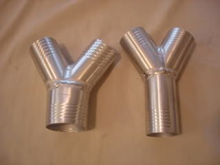

Is anyone here using the white magic filter box with a 2 1/2 hose conversion? I would like to covert to 2 1/2 hose this spring and I would like to convert the 3 outlet top on the filter box to a single 2 1/2 port. Any suggestions? maybe a plumbing supply house? That's the only thing I can think of right now.

If I am not mistaken, you have a 3" hose coming from the waste tank to your filter box. Do you not have 3 two inch nipples on the lid of the box for hose? If so, why not go 2 two inch hoses to a "Y" and then 2.5 inch hose from there.

It's simple.
email incoming
You just need one of these:
and no it doesn't come with any rivets or glue!

Greenie
6,820
Where ya been!
The one is just a 2" x2" the other is 2.5" x 2"
$49 and $59 respectively, they also come with a mounting plate option for $10 more.
It's a critical element in properly plumbing a 2.5 conversion.
