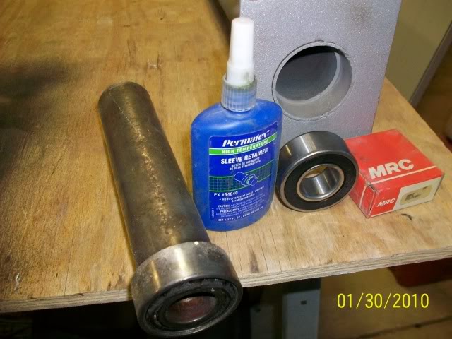

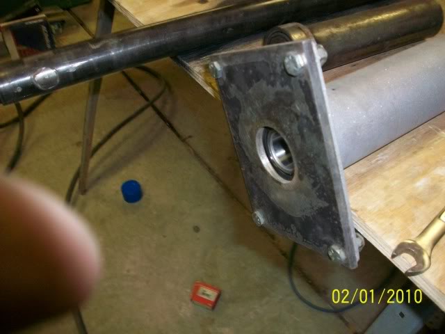

ANYONE that runs a shaft drive unit NEEDS a spare shaft...
number one......they're easy to put in and yor on yor way again! THEN fix the old unit and theres yor spare again.....
the shaft IS rebuildable IF you have the special bearing retainer that i built.......PLUS you'll need a bearing "installer" like this...
if you tear up the bearing race...it's STILL fixable but a LOT more expensive!
OH GEE.....look at that........i gots a "brand new" rebuilt one right here in my shop!
