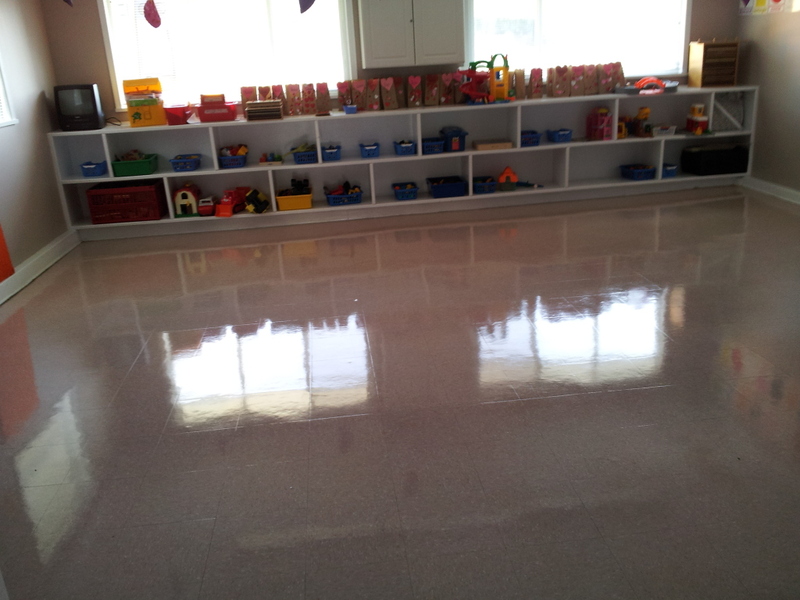

And you can use either a dry bright no burnish finish like this one or a burnishing finish. Look to see which has the most solids.
Ultrachem labs dry bright, no burnish, microfiber pad application after the strip.
