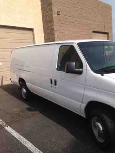

I looked at the Ford tonight. I'm pretty sure that's what I'm getting. 41,900 miles. Looks like new. I mean really looks new. Pool repair company has it. Had it wrapped so paint looks new. Garaged whole time so no sun. Damage. Cab feels like a brand new truck.
If I get it I'll post pics and document my new journey!
