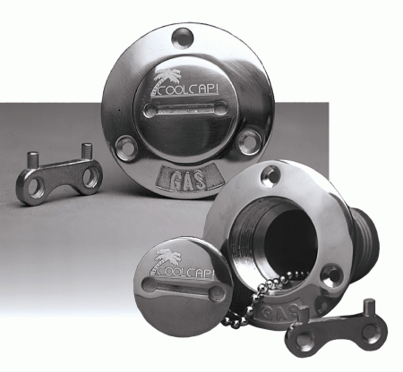

I'm planning to install this fuel cell with in-tank pump & sending unit onto my sprinter van. It's for a fuel injected ThermalWave.
I have no idea what vehicle this tank came from.
Do you think it will be ok to use this fuel pump? Or, is it a bad idea?
I already ordered the gas cap. the tank will be installed behind the rear axles and the fill neck will be on the driver side rear quarter panel. Haven't decided where to put the fuel gauge yet.

If that is a marine cap - you will likely end up with a vapor lock issue. Can't have a totally sealed system, air has to be introduced back into the tank as the fuel is removed.
If you use an in tank, any time it goes, you have to drop the tank to get to it (unless you have a top access panel through the van floor or the like).
Also - unless it matches the psi your TM needs, I wouldn't use it, unless you have a regulator installed as well.
