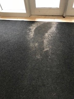

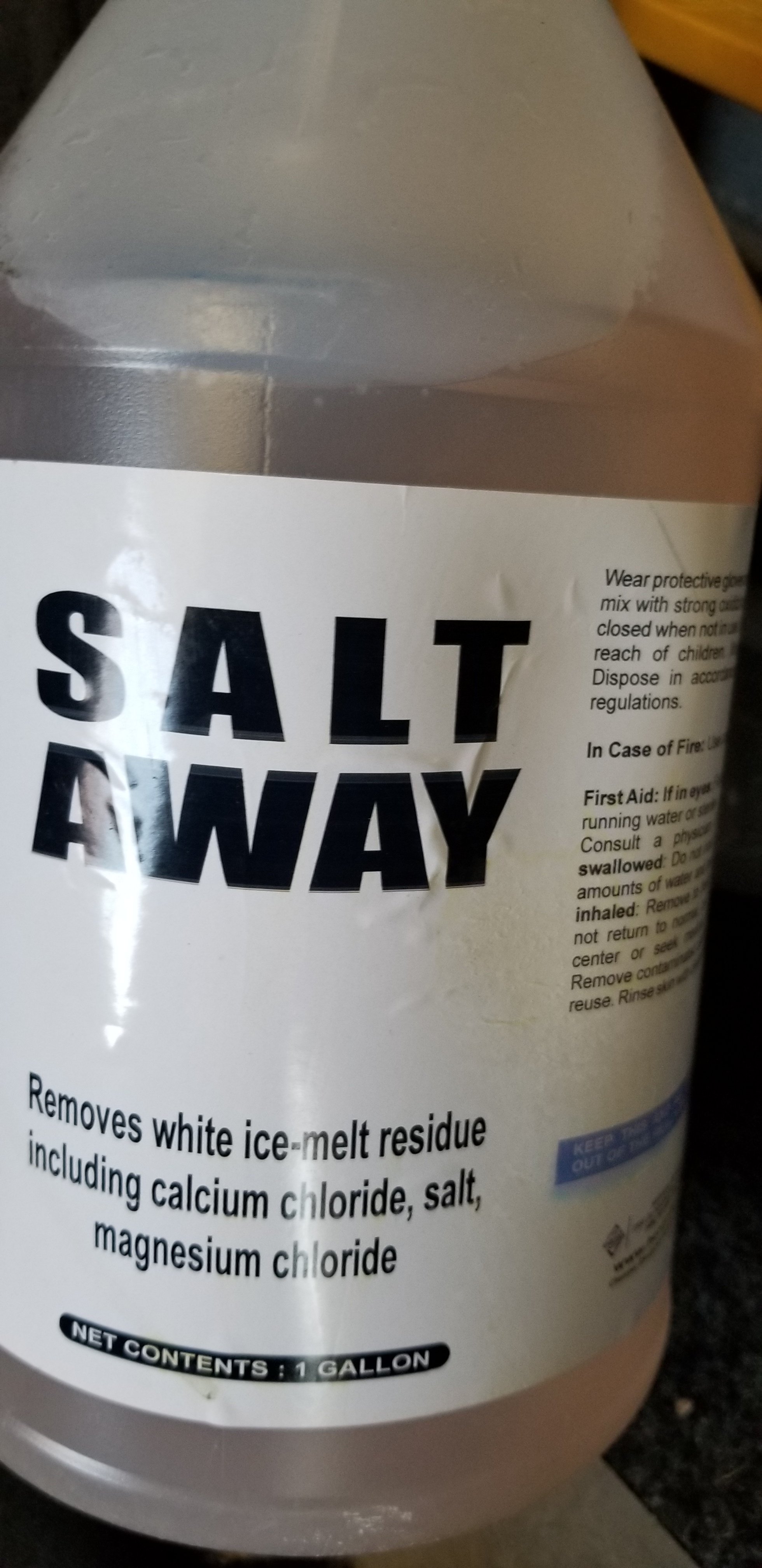

What are cleaners using to get out the salt from the winter?
Reactions: Mark Saiger
11,200
What are cleaners using to get out the salt from the winter? View attachment 80092
It's still difficult to get out....
We are working with a new test rinse right now also on acidic side to neutral and it has good cleaning and has been helping with our Salt remover prespray....but it's still tough on carpet...and tough to remove.
You are trying to now turn a salt lick-rock back into a liquid as fast as possible to make for easy removal.
It's takes more than one cleaning as well, because salt that deep can keep wicking up.
