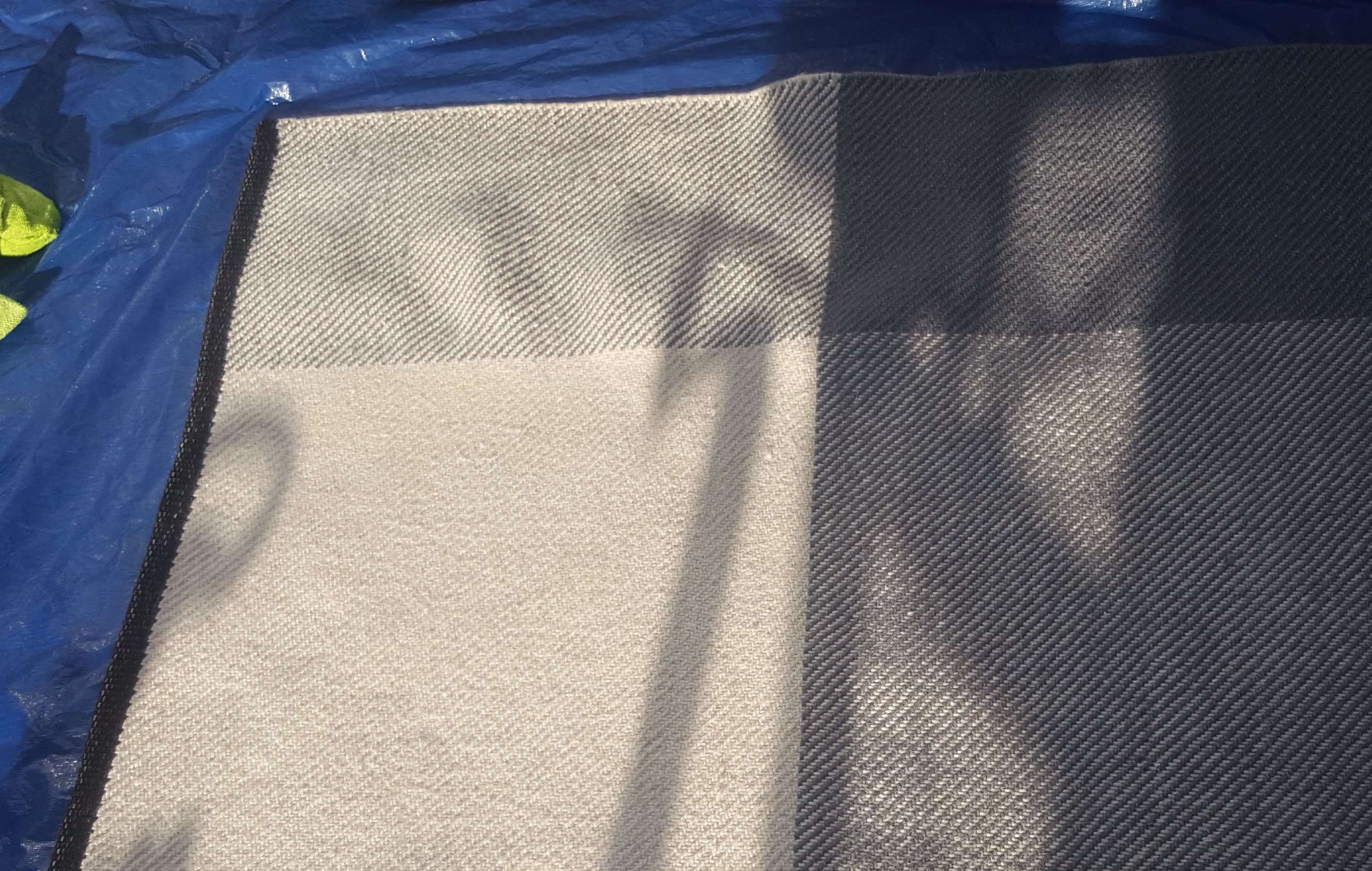

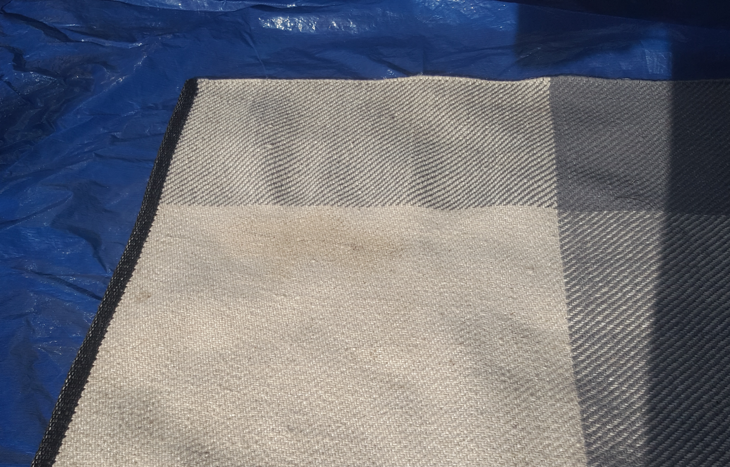

Did crock test and dye bleed test passed on both.
Tried distilled water took it half shade lighter as top pic, used light carbonated mix and its taken it to the bottom pic fading out nicely as it dries

Nicely done.
One of the hardest things we have to do is to avoid the highly alkaline, strong solvent blends or aggressive oxidizers and reducers that work so quickly and well on synthetics.
It takes patience, but it keeps you from decorating your home in "Early Screw Up"
Looks good, Dan.
What's light carbonated mix?
Rug looks warped. Was it not laying flat to begin with, did it dry flat?

Used soap free on it, I normally prefer reducers but thought I could always go there later if needed
wasn't completly flat to start with, waited till it was almost dry then hung it and its relaxed
