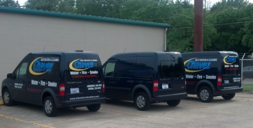

Xtreme Xtractor with Vac Pac wouldn't take up much space but any auto pump-out extractor would fit nicely in the Transit.
We love them, we had over 30-water losses last week and they we running drying to us and monitoring in them and picking up equipment in them. Worked great and we haven't even designed any shelving for them yet.

The guys said they had (2) Drizair 2000 dehumidifiers and 6-Drieaz X3 airmovers in there. You could probably get more if you have stacking skills like Lockhart. :p
