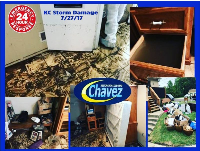

Personally we clean up following mold, trauma, sewage, hoardings, Cdif, MRSA and the cleaning of the school's carpet would be on the low end of risk for us.
However that is the great thing of being an independent business owner. You make decisions that are right for yourself.
These are types of jobs where I'm concerned about complete removal of affected materials and efficacy of cleaning.
Black contaminated water two foot high damaging everything it permeated.
