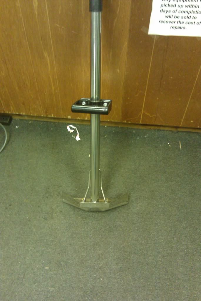

It is a 1.5 inch two jet straight handle stair tool. The cost is around 150. I would like to find a similar tool with two inch diameter. A glide is not neccessary but couldn't hurt. I have about 400 dollars of instore credit.

I have never used a stair tool. I have always used my upholstery tool, but now I just use my prochem wand. I need a stair tool for aesthic reasons and I know I am totally hacking steps out even though they look great when I am done. Atleast I vacuum them first. For 150 that tool would work great and I keep a 5 foot whip hose for upholstery that I could use with the tool. I want to hear from someone using Jeff's stair tool. Is it worth the price. It looks like a great tool. I agree about a glide on a stair tool. A slot would be great.

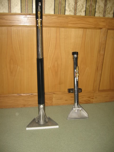

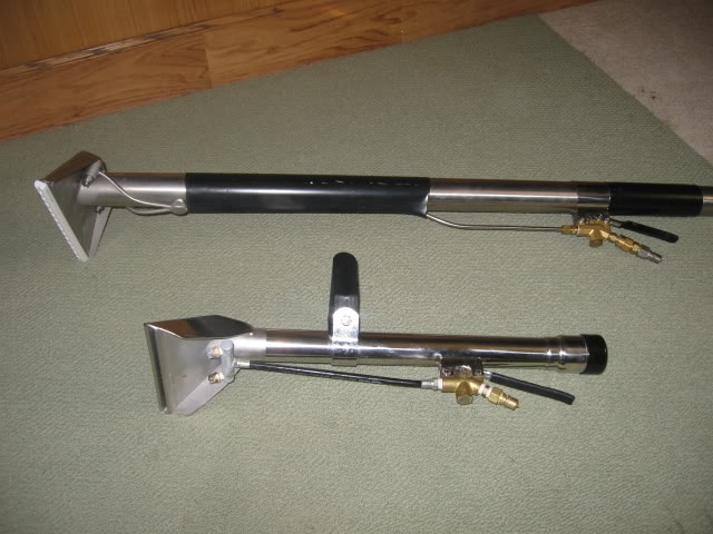

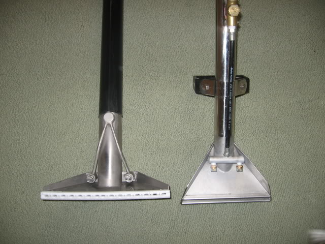

31,095
that would be me
the Greenie tool is the tall one
the other came from the e-bay vendor that Ryan put up a link for.
'cept i didn't notice if the one shown in Ryan's link accommodates 2" hose.
(that vendor sells both...one w/2" end and one w/1.5 )
Mines the "TM" stair tool = 2" end
It's an very good, solid well made tool and an EXCELLENT value.
The valve is a cheap "K" valve, but I've never had a problem with K and P valves.
They last us as long at the Westpac Feather touch valves that are board board de juor valve...they're just not a "feather touch" trigger.
but we don't blow silly PSI though .
The Greenie tool;
Build like a tank, rock solid and LONG
too long for "my" likes ..for stairs anyway.
I'd rather use a wand ...and do... then detail with the smaller, more agile tool when needed .
If you like a LONG stair tool, you should like GT
It's great (to me) as a multi-purpose tool though and I'm glad I have one on the van.
The Little Genies use both tools about equally for stairs from what I've observed ..seems like they grab which ever one is closer when reaching into the van...
Shane, the tall Little Genie (6' 2") likes the GT, Cody and I are about the same height (5' 9")
I see him using the shorter tool more often than not, unless Shane already brought in the GT
a glide on steps is a waste IMO....we've pulled ours off
mostly cause it's just not needed.
and secondly, if the steps are dirty, an unglided tool cleans better/deeper on cut piles.
